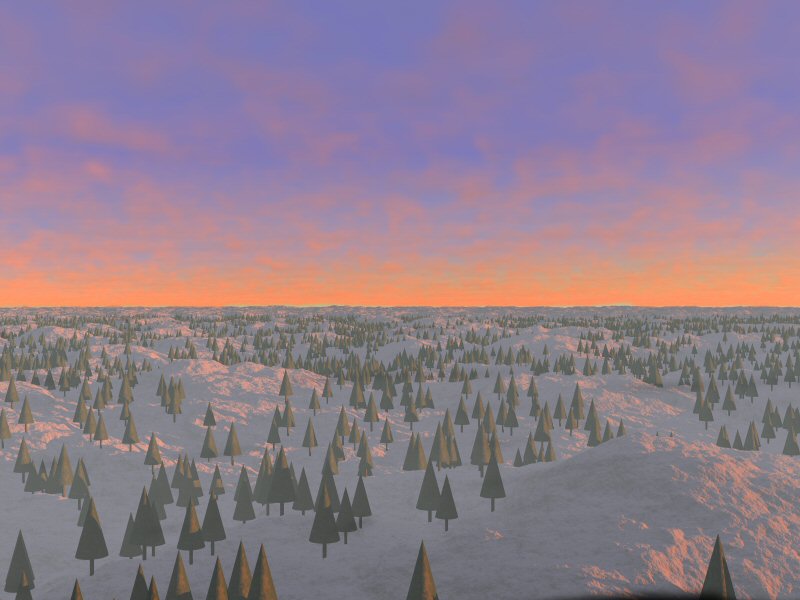

Well I added something better than a flat plane, and moved the camera under
the clouds.
For some reason it rendered *really* slow (and we're talking pixels per
minute here) if I tried to use the media clouds and the 10000 trees at the
same time.  So I rendered it twice, once without the clouds, and once
without the trees.  Then joined them together in paint shop.  Took about an
hour to render in total at 1600x1200 resolution.  I think it would have
taken a year to do it all in one go!

I can wholly relate to slow render times. :) I'll use it on my kids,
when I have a few, and tell them it builds character.
I like the sunset a lot. It was a little confusing before, with the
clouds below the camera and all. One question from someone who has had
mostly just static placement experience: how did you place the trees on
the terrain - I understand random placement - but how did you get them
to stay on top of the heightfield?
Great work. Some focal blur would be really cool too (but that would
kill your render time badly).
~Mike

too much ambient.  make finish{ambient rgb 0}
under
> the clouds.
It's a major improvement. The colors remind me of a sunset much more now. I
would suggest increasing the size of the clouds unless you're really going
for that wispy look.
> same time.
That's strange. Does it still do that if you add no_shadow to the trees? I
would understand the trees slowing things down because of shadow rays, but
not by *that* much. At least not in the upper half of the image.
> on the terrain - I understand random placement - but how did you get
> them to stay on top of the heightfield?
Well firstly, they're not entirely random, I made them more likely to go in
the lower bits of the terrain, and impossible for them to go on some of the
highest bits.  It looked a bit silly with them perched on the high bits of
the land.
And to get them at the right height, just use "trace".  It was the first
time I had used this, but remember seeing it elsewhere so looked it up in
the help docs.  Pretty easy to use.
Maybe I'll leave it running on my work PC over xmas!

I thought I'd set ambient=0, but I'll check.  There is a blue shadowless
light pointing down so maybe I'll reduce that a bit to see the result.
Which bit did you think looked too bright? The dark bits of ground or the
backs of the trees?

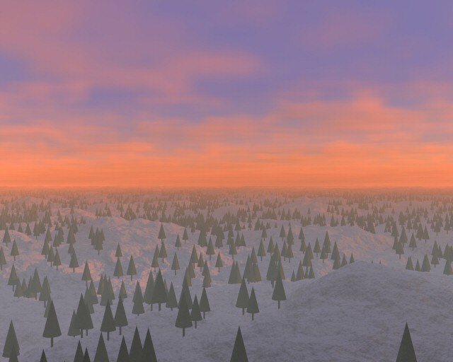

OK, well the no_shadow made it renderable in one go.  No idea why the tree
shadow would be affecting the sky rendering but hey it works.  Made the
clouds a bit bigger, messed a bit with the lighting and put some more media
in the air to make the ground fade to orange in the distance.
I'm thinking it just needs a house or something on that lump on the right in
the foreground.
Download 'sky2.jpg' (47 KB)
Preview of image 'sky2.jpg'

I like the media in the air. How long did this image take to render
overall (just curious how much that media slows it down)?
> the foreground.
A wolf would look really cool. :)
(but then, I just have something about wolves...)
~Mike
Not all that long as I expected actually - I think it took about an hour to
render 1280x1024 AA0.1 (for my desktop wallpaper!).
>> the right in the foreground.
Yes, a wolf howling would look great.  I'll have to look for a model.  I
would also move the camera down in closer so that wolf was actually a decent
size!
