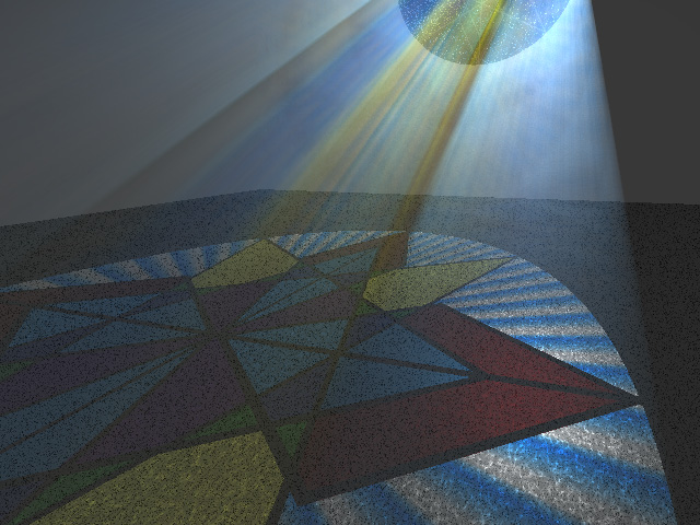

I started fiddling around with my stained glass window thursday and
started wondering what it
would look like with media.  An early render is attatched.
It's given me some Ideas for a new project, but it takes a long time to
render.
  Total Time:   19 hours 39 minutes 52 seconds (70792 seconds) --> On a
400 MHz Mac G4.
my media settings may be to blame, i had to confine them to a box with
the demensions of the room
or the scene whites out beyond the window.
box { <-29.375*ft, -0.015625, -39.625*ft> <29.375*ft, 49.375*ft,
39.625*ft>
 hollow on
 pigment { Clear }
 finish { ambient 1 diffuse 0 }
 interior {
  media {
   method 3
   intervals 5
   scattering { 2, rgb 0.0009 extinction .25 }
   samples 15, 25
//   confidence 0.9
//   variance 1/1000
//   ratio 0.9
  photons { pass_through reflection on refraction on }
I could probably turn off reflection in the photons block, I just didn't
think about it.

From: Darren New
Subject: Re: Stained Glass Window w/Media
Date: 24 Oct 2004 21:58:43
Message: <417c5dd3$1@news.povray.org>
The image on the floor looks a bit ... focussed. It wouldn't really be
that sharp. Maybe an area light on the other side of the glass or something?
The media is pretty well done, tho. :-)
From: Anthony D  Baye
Date: 25 Oct 2004 01:17:46
Message: <417C8C78.BD4DF8F2@gold.sdsmt.edu>
I've actually been trying to remove the window to an outdoor archway opening
onto a garden,
but I can't seem to get the media to behave the way It does indoors.  Maybe
this isn't possible
without forcing the effect with conical media containers or other tricks like
that.
Please correct me if I'm wrong...
ADB.
