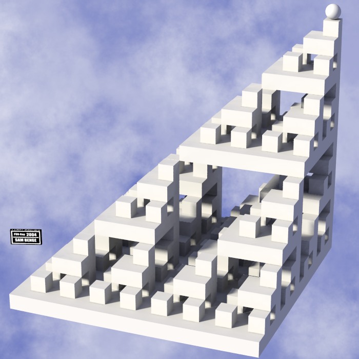

Okay, here's another one. This time, I simply adapted the code to work
in three dimensions instead of two. I did not even attempt to center the
pyramid in relation to itself.
Amazingly (at least to me) this render took only 3 minutes, 35 seconds!
It uses one 8x8 area_light and 'goodish' radiosity settings. About three
seconds and it was parsed.
Here's the basic code, for those interested. It's not super-efficient,
it simply works :)

Q's & C's, welcome as usual~
-Sam
