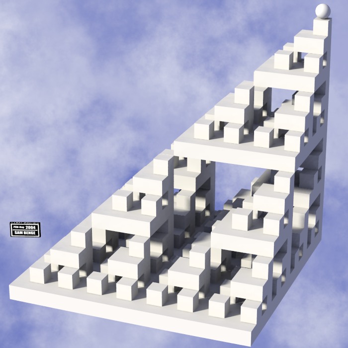

Okay, here's another one. This time, I simply adapted the code to work
in three dimensions instead of two. I did not even attempt to center the
pyramid in relation to itself.
Amazingly (at least to me) this render took only 3 minutes, 35 seconds!
It uses one 8x8 area_light and 'goodish' radiosity settings. About three
seconds and it was parsed.
Here's the basic code, for those interested. It's not super-efficient,
it simply works :)
//begin the code!
#declare obj=sphere{0,.5}
union{
  #local Y=1;
  #while(Y<17)
   #local Z=0;
   #while(Z<Y)
    #local X=0;
    #while(X<Y)
     #local t1=
      inside(obj,<X-1,Y-1,Z-1>);
     #local t2=
      inside(obj,<X-1,Y-1,Z>);
     #local t3=
      inside(obj,<X,Y-1,Z-1>);
     #local t4=
      inside(obj,<X,Y-1,Z>);
     #local T=t1+t2+t3+t4;
     #local obj=
     union{
      object{obj}
      #if(T=1|T=3)
       box{-.5,.5 translate<X,Y,Z>}
       #else sphere{0,.1}
      #end
     #local X=X+1;
    #end
    #local Z=Z+1;
   #end
   #local Y=Y+1;
  #end
object{obj pigment{rgb .7} rotate z*180+y*55 translate<10,10.5,0>}
//end code
Q's & C's, welcome as usual~
-Sam
