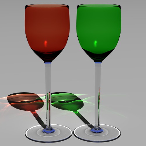

These are two lathe-glasses with colored media in the upper part (and some
media in the lower part...).
My problem is, how to fill in some water (or something else).
I know, how to make the water the size it would perfectly fit in, but then
you got the "coincident surfaces problem"...
What should I do to let the ior-statements play together well (Having only
one surface between the water and the glass with "ior 1.33" to "ior 1.5")?
-Remove some surfaces with clipped_by
-Scale the water a tiny bit up, so we got some water in the glass?
-Scale it down, to have some air between the glass and the water?
-Something completely different?
(I remember faintly, that scaling it up a bit should do it, because POV-Ray
would realize this, would make only one surface from glass to water - but I
don't know anymore...)
I searched the faq (Helpfile: 2.4) but didn't find anything - I think this
could be a candidate to be added.
Thanks in advance!
Kalle

Well, obviously you just have to alter the points a little - either
manually or automagically. If you have the glass points in an array, you
can easily multiple every x-coordinate by some value (<1) or subtract a
small value to keep the gap constant.
Or if you want a bit larger liquid you multiply with a value (>1) or add
something.
I think the adding/subtracting is a better way actually because of the gap.
I don't know whether the liquid should be larger or smaller than the
container. So I would also like to know what is the most accurate way to
model that. Also, should there be specular reflections where the glass
and liquid meet?
Severi S.

Larger, if it's smaller you'l get an air-gap with a lot of internal
reflections.
Ingo

Ok, but how does POV handle the situation where a ray intersects a new
different IOR surface before "exiting" the previous? Does the ray just
get bended more for this short overlapping portion and then back to normal?
Severi S.

I think when it hits the first surface (the water surface), it accepts that
it's inside water and uses the water ior (as far as it knows, it's going to
come out of the water before it comes out of the glass). Then, when it comes
out of the glass, it recognizes that it's been in overlapping materials and
doesn't change the ior; it simply continues through the surface of the glass
and into the water.
 - Slime

Sounds reasonable but is this confirmed information?
Severi

There is an excellent example of how to do this posted by one "tommy" on
April 27, 2004.
Here is a link to the image.  In one of the followups, the author also links
to the posted the source code.
http://news.povray.org/povray.binaries.images/thread/%3Cweb.408df5996f50dd40a472d3920@news.povray.org%3E/
Maybe that's not "the best" way to do it, but the results seem impressive.
Jeremy
www.beantoad.com

I don't know, if the following contradicts your statement: I have tested,
and there is a visual difference between:
difference { // the glass with hole
  sphere { <0,5,0>,5 }
  sphere { <0,5,0>,3 }
  interior {ior 1.5}
sphere { <0,5,0>,3.5 // the water
  interior {ior 1.33}
and
//difference { // the glass with hole
  sphere { <0,5,0>,5 //}
//  sphere { <0,5,0>,3 }
//  interior {ior 1.5} // without hole...
sphere { <0,5,0>, 4 // the water
  interior {ior 1.33}
So - the surface between "glass and water" to water can be seen. It's not:
"<Beeing in glas> O! there is water, well a guess I leave the glass here and
enter the water <then hitting the end of glass> well, I've already left - so
forget it <ignoring this surface>!"
But maybe it's right-looking this way... I have to do some more tests.
Kalle
