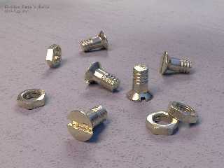

Hi,
The idea to make a "Nuts and Bolts" scene came from Tek. I used the same
settings as before (the Parfum Flacon post). Well, maybe the metal is
actually too shiny. I don't know. I also don't know if this is supposed to
be copper or gold. What do you think? I think the bolts look quite "melted"
too, but that might have to do with the modelling rather than the
material... Btw, they are modelled in Wings3d... Comments, suggestions?
Thanks.
Hugo
Download 'Golden Nuts 'n Bolts.jpg' (85 KB)
Preview of image 'Golden Nuts 'n Bolts.jpg'

Hugo Asm wrote:
> Hi,
The bolts (screws?) do look a bit melted, but I don't know if modeling
or a normal is at fault for that.
The metal looks a little like brass plating or something (although it's
a little bright/pale for brass). I wouldn't say they're necessarily
*too* shiny. Reflections look good.
If you're going for photorealism here, you'll want a more realistic
surface for them to rest on.
-Xplo

Stunningly realistic to my eyes. Perfect for being tiny in size, screws are
about right for computer drive hardware... colors too. Not sure I'd describe
those as golden. Maybe chrome-like shown under incandescent room light.
Image contrast looks very good to me, with highlights being sharp and
shadows dark. It's a beautiful job of rendering.
Bob H.

Wow, very realistic :)
I'd probably suggest somehow softening the reflection a bit on the
meatal, though. But, still, they are nice in their own right. It seems
like Jamie's (www.ignorancia.org) nust&bolts had a softer texture, IIRC
he used a micronormal to acheive the desired effect.  But, if shiny is
what you're going for, then these are perfect!

Just perfect! Some chromed steel bolts and nuts. The small nicks in the
front one groove adds tons of realism.
are
I agree.  Great job modeling and texturing, Hugo!
Could the chrome-like appearance be due to a blue sky_sphere?  That would be
my best guess.  If so, simply changing the sky_sphere and/or other
surroundings may make them look a little more golden.
Jeremy

I would improve the texture of the ground to add much more realism to the
whole scene. But the nuts&bolts are amazing.
Congrats,
Fernando

Okay, I'm increasing my score. That's gotta be a 9.5 for that material. At
least. I've seen things that look like that! Are those imperfections in the
model or in the material? They really make it look convincing.
Though I'm surpised it looks that good on these objects, since it's obviously
not the kind of metal they'd usually be made from. Still, it's enough for me to
judge that is looks right.
I'm not sure what to suggest to improve it. It looks a bit shiny and smooth,
which usually makes things look less realistic, but then there are metals that
really look like that and if you less smooth then you'll make it look like a
different material. So I guess my only suggestion would be to do several
different materials based on this, so you could make a red/orange version for
copper, a brown one for brass, etc.
