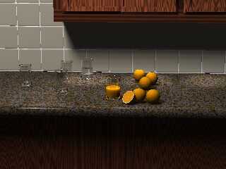

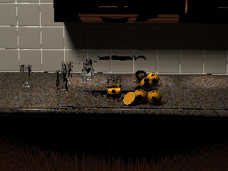

Here's the images associated with a similarly named post in p.g ...
I'll try to pare down the scene to get a repro file for the dev team.
Download 'oj-rad.jpg' (21 KB) Download 'oj-norad.jpg' (22 KB)
Preview of image 'oj-rad.jpg'
Preview of image 'oj-norad.jpg'

Hmmmmm. Wish I knew the real reason for the change but it manifests itself
somehow in the position of the lights and adaptive value of the area lights.
To see what I mean, try dividing the first light's position vector by 1.1,
which will be <-15, 45, -35>/1.1. Also give it adaptive 2 instead of 0.
Change the three under-cabinet spotlight positions so that they are at y=9
and z=4, x remaining same.
Make the second area light adaptive 2, as well.
In your posted scene script you had put a max_trace_level 200 at the top, it
belongs in the global_settings block but I found it wasn't needed to see the
supposed solution.
Looks like the second box in the union of the CounterBody object ends up
with its lowest side where those three under-counter lights were (are), so
you'll need to watch out for those kinds of alignments. The coincident
surfaces phenomenon tends to include lights and camera at object surfaces.
Bob H.

From what I have seen the coincident surfaces problem usually manifests
itself as a random speckling of the object and/or light source. In reality,
the spotlight should not affect the cabinet above them. I am a bit suprised
I didn't see the usual coincident surfaces issue before in this scene.
All in all, this has the hallmarks of an accuracy problem. (i.e. really far
away objects viewed with a really narrow camera angle seem to have drop-out
like this). But in my case, the values are within practical limits..
Hmmm...

It definitely merits looking into, I believe. What I thought was fixed by
moving the light sources actually remains artifact-prone when changing
resolutions. Very peculiar. Has me baffled since the scene file isn't what
I'd call extreme, so worries me a little. A couple area lights, three spot
lights, some primitives like box, plane, cylinder, sphere... I checked using
a simple pigment {color rgb 1} in place of the textures, and the blanking
out parts stayed so I figured it couldn't be related to max_trace_level.
Just now, I found out the 'media on' in radiosity will cause the blanking.
Commenting it out I can render the scene okay even though all lights are in
their original positions. I should have tried that before. In fact, there's
a relation with 'count' too, because count 50 clears it up while media is
on.
