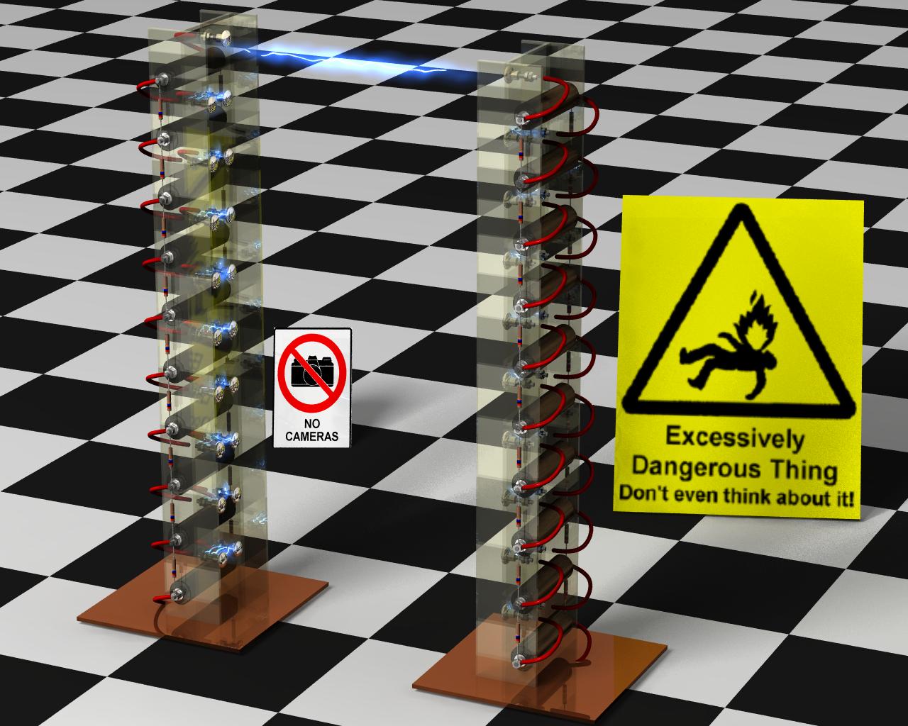

Latest improvements, but my sparks still don't throw any light.
Also, still having trouble getting the spark ends to end at the terminals.

Dave VanHorn nous apporta ses lumieres ainsi en ce 2004/05/19 21:17... :
Double check that you have "media on" in the radiosity settings.
Try broadening the bright part of your media, so there is more of it to
emit light.
If scaling down, multiply the density by as much as you reduced the size.
Hoping to be of any help :-)
I do.
emit light.
Thought about it, but then it dosen't look real.
I posted the spark code, and now I'm using the fixed macro that Ger posted
yesterday with a string of lights.
Originally, I had a spline sweep, but I wasn't having any luck getting good
shapes, or illumination from it.
