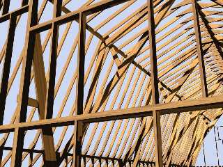

Here's a more complete version of the frame.  The second picture shows
the wind brace on the end, as Remy Closset mentioned.  There are still a
few more changes to be made, such as, there really should be a smaller
door on the front left, since the back is north, and the barn is
supposed to be placed to the northeast of the house, given the
prevailing westerly winds in the midwest USA.
Thanks for all the advice on woodgrain, shingles, etc.  More comments
greatly appreciated.
Dave Matthews
Download 'frameview03.jpg' (88 KB) Download 'frameview05.jpg' (118 KB)

As I look at it, I'm sure that there should be trusses nearer to the
ends -- it looks far too flimsy this way, although the plans didn't show
this, and the details of tying in the faces clearly show that there are
not supposed to be trusses at the very ends.
Oh, well.  It's easier to fix with POVRay than it would be in the other
real life.
Dave Matthews

Thanks!  I made some improvements over the weekend, but not enough to
warrant another post.  After looking at a neighbor's (smaller but
similarly supported) barn, I decided that the trusses should be 12 feet
apart, rather than 16, and start closer to the barn face, so now there
are 7 trusses instead of 4, making it look much more substantial.  Also
I noticed that the roof frame should extend 2 feet past the barn (for an
overhang), and that the center "point" (I can't remember its name)
should be only as wide as the haymow doors, and extend further out, to
protect the pulley assembly (again I forget the name) used to get the
hay into and out of the loft.
Anyway, I thought about trying to make just the outside, but my
observational skills are so poor, that usually someone comes by and says
"that barn (or whatever) couldn't even stand up the way you made it."
The nice thing about a barn is that, even when (if) it's completed,
you'll still be able to see all of the construction details (from the
inside).  It's also interesting to see how far you can get with just one
primitive ("box.")  I'm not sure if it's practical to go any further
with just boxes, since next come the lathes, and then the siding and
shingles, and that's a lot of boxes.  I'm also toying with whether or
not to include the internal ventillation, although the engineering
aspects of that are really fascinating (how do you most efficiently
remove methane from the barn and put it out into the atmosphere, where
it belongs?)
Thanks for the interest and comments.
Dave Matthews

Heres a bit of shingles code for you, new and improoved!
#include "colors.inc"
#include "textures.inc"
#include "functions.inc"
#include "shapes.inc"
#include "woods.inc"
camera  { location <10,0,-40> look_at <10,0,0> }
background { Blue }
light_source { <900, 560, -500> color White }
light_source { <-900, -560, -500> color White }
light_source { <900, 560, 500> color White }
light_source { <-900, -560, 500> color White }
#declare rStream = seed(0);
#macro
RowOfShingles(heightOfShingle,widthOfShingle,depthOfShingle,lengthOfRow,theT
exture)
        #declare currentLength = 0;
        #declare gapBetweenShingles = 0.1;
        union   {
                #while(currentLength < lengthOfRow)
                        #declare thisShingleWidth = widthOfShingle +
(rand(rStream)*(widthOfShingle/2));
                        box     {
                                <currentLength,0,0>,
<currentLength+thisShingleWidth,heightOfShingle
+rand(rStream),depthOfShingle>
                                texture {
                                        theTexture
                                        rotate
<rand(rStream)*360,rand(rStream)*360,rand(rStream)*360>
                        #declare currentLength = currentLength +
thisShingleWidth + gapBetweenShingles;
                #end
#end
#macro
Rows(heightOfShingle,widthOfShingle,depthOfShingle,lengthOfRow,theTexture,Ro
wCount)
        #declare myCount = 0;
        union   {
        #while(myCount <= RowCount )
                object  {
                        RowOfShingles(3,2,0.5,40,theTexture)
                        translate
<0,(heightOfShingle/2)*myCount,(depthOfShingle*myCount)*-1>
                #declare myCount = myCount + 1;
        #end
#end
#declare myShingles = texture { pigment { P_WoodGrain1A color_map {
M_Wood9A } scale 4} };
object  {
        Rows(3,2,0.5,60,myShingles,12)
        rotate <200,0,0>
        translate <-10,20,0>
From: Dave Matthews
Subject: Re: Dairy Barn(Take 2) (88k and 118k)
Date: 29 Mar 2004 09:38:49
Message: <406834f9$1@news.povray.org>
Thanks!  That's very nice, very useable, and very understandable!
Dave Matthews

i must be rendering it incorrectly, it looked like chipboard
currently playing with a tutorial series wood_1..19.pov  (its on other
box at moment, that i found semms to me, something is wrong with
rand(R)*360 on all of x,y,z for the rotate
istr something in docs about 5-10 degrees about x or z axes's, the
direction i think is really z (grain direction)
so i'm playing with different fading on some of the straighter grained
wood textures.
stephen
