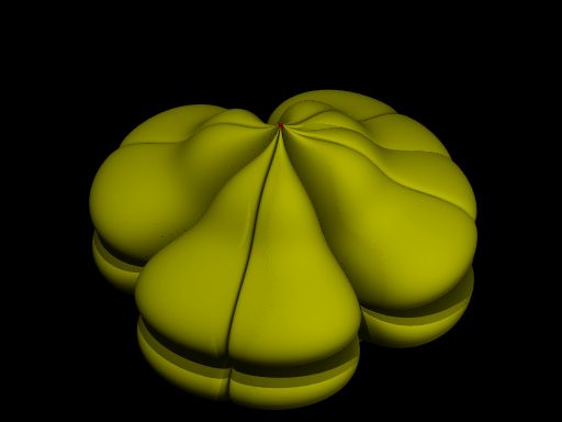

I did some experiments to express the SuperFunction from
Dave Vogt's post with a single isosurface. It seems to work
fine.
Dave's original links:
[1] http://www.heise.de/newsticker/meldung/45863
[2] http://www.genicap.com/
[3] http://astronomy.swin.edu.au/~pbourke/povray/supershape/
The PovRay code as a Macro:
#macro Super_Function_3D (m1, a1, b1, n11, n21, n31, m2, a2, b2, n12, n22, n32 )
   isosurface {
     function {
                pow(  pow(abs(cos(0.25*m2*asin(z/sqrt(x*x+y*y+z*z)))/a2),n22)  +
                      pow(abs(sin(0.25*m2*asin(z/sqrt(x*x+y*y+z*z)))/b2),n32)
                    ,1/n12)  *
                pow(  pow(abs(cos(0.25*m1*acos(y/sqrt(x*x+y*y))*abs(y)/y)/a1),n21)  +
                      pow(abs(sin(0.25*m1*acos(y/sqrt(x*x+y*y))*abs(y)/y)/b1),n31)
                    ,1/n11)  *
                    sqrt (x*x+y*y+z*z)
                - 1
     max_gradient 20
     contained_by { box { <-2,-2,-2>,<2,2,2> } }
#end
And a test image with the following parameters taken from an example on link [3]:
{ Super_Function_3D ( 7, 1, 1, 20.45, -0.33, -3.54, 6, 1, 1 ,-0.96, 4.46, 0.52 ) }
Regards, Hans
Download 'superfunction_isosurface.jpg' (14 KB)
Preview of image 'superfunction_isosurface.jpg'

Hans de Vries wrote:
>     function {
>                pow(
>                    ,1/n12)  *
>                pow(
>                    ,1/n11)  *
>                    sqrt (x*x+y*y+z*z)
>                - 1
You can _try_ to increase the rendering speed, by replacing
'sqrt(x*x+y*y+z*z)' with 'f_r(x, y, z)' and 'sqrt(x*x+y*y)'
with 'f_r(x, y, 0)'.
Also you should have a look at the internal functions;
'f_th()' and 'f_ph()'.
http://www.povray.org/documentation/view/244/
Because it seems like these may enable you to simplify some
of your inverse trigonometric expressions.
E.g. this one: 'acos(y/sqrt(x*x+y*y))*abs(y)/y'
In order to use these functions, you must first include the
'functions.inc' file.
P.S.: antan2() is also useful.
Tor Olav

The simplest version for the time being below. It speeds things up with circa 25%
The trick is to get the right ranges for theta (-pi..+pi) and phi (-pi/2..+pi/2)
and avoiding divides by zero.
   isosurface {
     function {
                pow(  pow(abs(cos(0.25*m2*(f_ph(x,z,y)-pi/2))/a2),n22)  +
                      pow(abs(sin(0.25*m2*(f_ph(x,z,y)-pi/2))/b2),n32)
                    ,1/n12)  *
                pow(  pow(abs(cos(0.25*m1*atan2(x,y))/a1),n21)  +
                      pow(abs(sin(0.25*m1*atan2(x,y))/b1),n31)
                    ,1/n11)  *
                    f_r(x,y,z)
                - 1
     max_gradient 20
#end
Regards, Hans
> circa 25%
> (-pi/2..+pi/2)
Often it will also help to "predeclare" constants so that they
don't have to be evaluated over and over again at rendertime.
E.g.:
#macro Super_Function_3D()
#local HalfPi = pi/2;
#local mm1 = 0.25*m1;
#local mm2 = 0.25*m2;
#local inn11 = 1/n11;
#local inn12 = 1/n12;
isosurface {
   function {
     pow(
       pow(abs(cos(mm2*(f_ph(x, z, y) - HalfPi))/a2), n22) +
       pow(abs(sin(mm2*(f_ph(x, z, y) - HalfPi))/b2), n32),
       inn12
     pow(
       pow(abs(cos(mm1*atan2(x, y))/a1), n21) +
       pow(abs(sin(mm1*atan2(x, y))/b1), n31),
       inn11
     f_r(x,y,z)
     - 1
   max_gradient 20

I enjoyed the images at your photo side.
http://subcube.com
Some very nice isosurfaces over there :^)
Regards, Hans
> http://subcube.com
Thank you Hans !
If you are interested in further "tricks" to make isosurfaces
render faster in POV-Ray you can find some in this thread:
http://news.povray.org/povray.text.scene-files/thread/%3Cweb.3fbbe555cd7b5c811235fd70%40news.povray.org%3E/
(Alex Kluchikov's thread "My favourite isosurface" posted
19. Nov. 2003 to povray.text.scene-files)
Or more specific:
http://tinyurl.com/2fbt5
http://tinyurl.com/yu42p
http://tinyurl.com/24dqh
http://tinyurl.com/3f642
