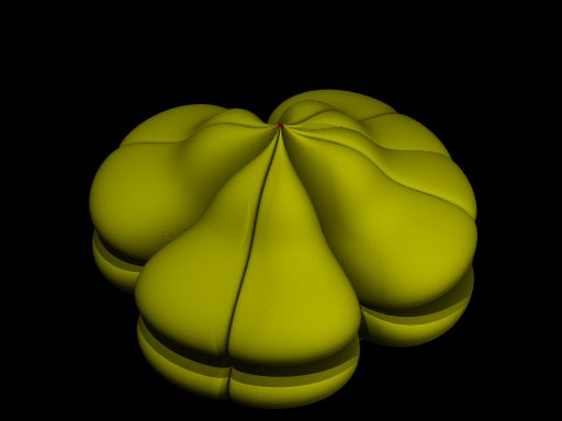

I did some experiments to express the SuperFunction from
Dave Vogt's post with a single isosurface. It seems to work
fine.
Dave's original links:
[1] http://www.heise.de/newsticker/meldung/45863
[2] http://www.genicap.com/
[3] http://astronomy.swin.edu.au/~pbourke/povray/supershape/
The PovRay code as a Macro:
#macro Super_Function_3D (m1, a1, b1, n11, n21, n31, m2, a2, b2, n12, n22, n32 )
   isosurface {
     function {
                pow(  pow(abs(cos(0.25*m2*asin(z/sqrt(x*x+y*y+z*z)))/a2),n22)  +
                      pow(abs(sin(0.25*m2*asin(z/sqrt(x*x+y*y+z*z)))/b2),n32)
                    ,1/n12)  *
                pow(  pow(abs(cos(0.25*m1*acos(y/sqrt(x*x+y*y))*abs(y)/y)/a1),n21)  +
                      pow(abs(sin(0.25*m1*acos(y/sqrt(x*x+y*y))*abs(y)/y)/b1),n31)
                    ,1/n11)  *
                    sqrt (x*x+y*y+z*z)
                - 1
     max_gradient 20
     contained_by { box { <-2,-2,-2>,<2,2,2> } }
#end
And a test image with the following parameters taken from an example on link [3]:
{ Super_Function_3D ( 7, 1, 1, 20.45, -0.33, -3.54, 6, 1, 1 ,-0.96, 4.46, 0.52 ) }
Regards, Hans
Download 'superfunction_isosurface.jpg' (14 KB)
Preview of image 'superfunction_isosurface.jpg'

From: Hans de Vries
Subject: Re: Super Shapes with isosurface
Date: 22 Mar 2004 22:17:04
Message: <405fac30$1@news.povray.org>
The simplest version for the time being below. It speeds things up with circa 25%
The trick is to get the right ranges for theta (-pi..+pi) and phi (-pi/2..+pi/2)
and avoiding divides by zero.
   isosurface {
     function {
                pow(  pow(abs(cos(0.25*m2*(f_ph(x,z,y)-pi/2))/a2),n22)  +
                      pow(abs(sin(0.25*m2*(f_ph(x,z,y)-pi/2))/b2),n32)
                    ,1/n12)  *
                pow(  pow(abs(cos(0.25*m1*atan2(x,y))/a1),n21)  +
                      pow(abs(sin(0.25*m1*atan2(x,y))/b1),n31)
                    ,1/n11)  *
                    f_r(x,y,z)
                - 1
     max_gradient 20
#end
Regards, Hans
