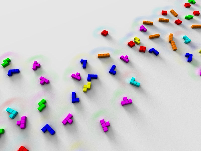

I've not seen this one before. I have this simple scene with some coloured
blocks lying on a white floor, with a light source in one direction and
radiosity set to Radiosity_Final from rad_def.inc. As you can see the blocks
seem to cause an echo in the inverse of their colour, in the direction of the
light (as if somehow they'd reflected negative light!?)
Anybody seen this before? Have I done something crazy?
Source code available if anyone wants it.
Tek
www.evilsuperbrain.com
Download 'tetri.jpg' (63 KB)
Preview of image 'tetri.jpg'

Could You post full code (maybe in .b.scene

After a quick look, I would start with decreasing diffuse to 0.9 (1.0 diffuse does not
occure in nature, well at least in normal materials).
Maybe You would also try for example following radiosity settings:

That's very interesting, and you make a good point about diffuse, but it doesn't
explain the artefacts!
I'm not interested in getting round the problem, that's easy! I want to know why
it happens.
Tek
