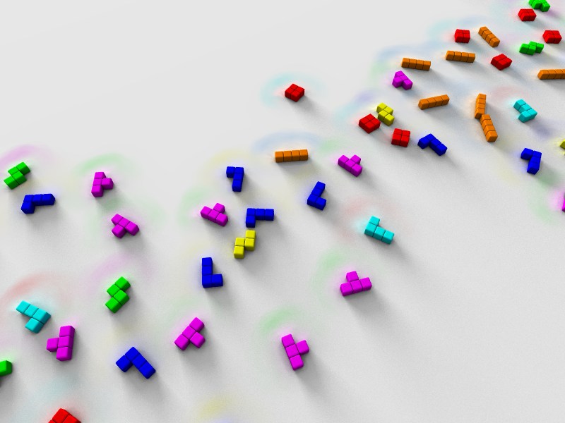

I've not seen this one before. I have this simple scene with some coloured
blocks lying on a white floor, with a light source in one direction and
radiosity set to Radiosity_Final from rad_def.inc. As you can see the blocks
seem to cause an echo in the inverse of their colour, in the direction of the
light (as if somehow they'd reflected negative light!?)
Anybody seen this before? Have I done something crazy?
Source code available if anyone wants it.
Tek

From: Rafal 'Raf256' Maj
Subject: Re: wierd radiosity error
Date: 4 Mar 2004 03:00:15
Message: <Xns94A25B6E1D2D7raf256com@203.29.75.35>
tek### [at] evilsuperbraincom news:4046cfee@news.povray.org
> coloured blocks lying on a white floor, with a light source in one
> direction and radiosity set to Radiosity_Final from rad_def.inc. As
> you can see the blocks seem to cause an echo in the inverse of their
> colour, in the direction of the light (as if somehow they'd reflected
> negative light!?)
Could You post full code (maybe in .b.scene
Date: 4 Mar 2004 04:27:09
Message: <Xns94A26A29A2EC9raf256com@203.29.75.35>
tek### [at] evilsuperbraincom news:4046e96e$1@news.povray.org
> Done.
After a quick look, I would start with decreasing diffuse to 0.9 (1.0 diffuse does not
occure in nature, well at least in normal materials).
Maybe You would also try for example following radiosity settings:
#local QQ_RAD = 4; // <===== set this variable 0,1,2,3,4,5,6 or 7
#declare CFG_AMB = 0.3; // <==== set this variable for ambient when NOT using

From: Tek
Date: 4 Mar 2004 04:33:39
Message: <4046f7f3$1@news.povray.org>
That's very interesting, and you make a good point about diffuse, but it doesn't
explain the artefacts!
I'm not interested in getting round the problem, that's easy! I want to know why
it happens.
Tek

>     radiosity{ Rad_Settings(Radiosity_Fast,on,on) }
> No nasty parameters there! You just decide what quality you want and off
you go
(I don't have POV here) -- is that a standard include? If so, awesome!
From: Tek
Date: 5 Mar 2004 23:42:13
Message: <404956a5$1@news.povray.org>
"Dan P" <dan### [at] yahoocom> wrote in message
news:4048fdce$1@news.povray.org...
> > #include "rad_def.inc"
Yup, it's one of the standard ones. It is truly awesome!
Back in the days of megapov I struggled to get radiosity set the way I wanted
it, and now these presets are higher quality and faster than the settings I used
to use!
Tek
www.evilsuperbrain.com
