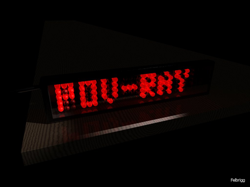

Heres my experiment with Radiosity.  I've been trying to make the LEDs
brighter so that they give off more light but I must be missing a trick 'cos
as I try to brighten them ( by upping the ambient) they start getting
artifacts or artificial shadows on the lit up LEDs.  The source is below and
an image attached.  If you can give me a pointer on how to get brighter
reflection of the LEDs on the tabletop i would appreciate it.  The code for
the LED is in the LED Macro.
BTW if anyone has any ideas on how to represent an "M" in a 3x5 grid,
suggestions welcome.

object  { Round_Box(<-42,0,-17>,<100,-5,1000>,0.2,no)
        texture {
                SnakeWood scale 1
                finish  {
                        ambient 0
                rotate <0,5,0>
        texture {
                pigment { color rgbf< 0.7, 0.8, 0.98,1> }
                finish  {
                        reflection {0.1,0.2}
                        specular 0.5
                        ambient 0
                        diffuse 0.7
light_source {
        <40,70,-50>
colour White
        spotlight point_at <-55,0,0>
                tightness 50
                radius 7
                falloff 10
                photons {
                        reflection on
                        refraction on
//cylinder { <40,70,-50>,<-55,0,0>,1 texture { pigment { Red } } }
 //light_source { <0, 20, -50> color rgb <0.2, 0.25, 0.3> shadowless }
//light_source { <-70, 40, -10> color White photons { refraction on
reflection on } }
//light_source { <-70, 20, 0> color White photons { refraction on reflection
on } }
//light_source { <-35,14,3> color White photons { refraction on reflection
on } }
Download 'LEDPanel2.jpg' (49 KB)

From: Felbrigg
Subject: Re: [WIP] LED Panel
Date: 2 Mar 2004 10:57:02
Message: <4044aece@news.povray.org>
I did consider that, but I havn't used arrays yet either!
"LightBeam" <s.f### [at] tiscalifr> wrote in message
news:4044ad0c$1@news.povray.org...
> for example : Letter 'O' :
> 00111100
> 01000010
> 01000010
> 01000010
> 01000010
> 00111100
> But I don't really know (yet) how to use arrays... So it's just a
> suggestion....
From: Marc Roth
Date: 2 Mar 2004 11:53:09
Message: <4044bbf5$1@news.povray.org>
M might be done like this:
o x o
o o o
o x o
o x o
o x o
bye,
	Marc
From: Felbrigg
Date: 2 Mar 2004 12:28:29
Message: <4044c43d$1@news.povray.org>
Thanks but I've been there and my co-workers ripped the *iss out of me for
it.
I really think I should have done a 5x8 grid. The word to describe me, i
think, is PLONKER!

From: Cris Williams
Date: 5 Mar 2004 21:23:05
Message: <40493609$1@news.povray.org>
Cool, this has a lot of potential.  Why not fill the panel with a solid grid
of LEDs.  Then you could animate it by having the text scroll by.  :)
