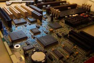

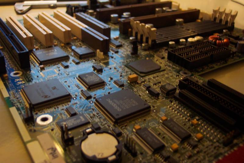

Prompted by a post a few days/weeks ago I looked up a project I worked on a
few years ago
This is an actual mainboard (Intel DK440LX, see pic)
I stopped working on it because I couldn't figure out how to make the
printed tracks and the silkscreen (the white prints). I tried scanning and
photographing it but it didn't come out good enough. And handcoding all the
wires and texts is a bit too much work
Ideas, comments, complaints etc welcome
Ger

For that you need a hires scan and that gets frigging huge because it's a
very large board (305x330 mm). I have tried it though but it didn't work
out, the scan never came out good enough

You mean the holes in the board? they are that light because of the
underlying plane
> This is freeking' sweet.
Thanks :)
> I love this board (pun intended!)
Me too, only problem is, it's dead :(
Ger
