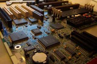

Prompted by a post a few days/weeks ago I looked up a project I worked on a
few years ago
This is an actual mainboard (Intel DK440LX, see pic)
I stopped working on it because I couldn't figure out how to make the
printed tracks and the silkscreen (the white prints). I tried scanning and
photographing it but it didn't come out good enough. And handcoding all the
wires and texts is a bit too much work
Ideas, comments, complaints etc welcome
Ger

Dan P wrote:
> Okay, WOW... ambitious!!!
> For the silkscreen, how about building a hi-res texture for it in
> Photoshop/Gimp/etc? You can use the circuit traces as a bump_map too to
> get a raised look.
For that you need a hires scan and that gets frigging huge because it's a
very large board (305x330 mm). I have tried it though but it didn't work
out, the scan never came out good enough
