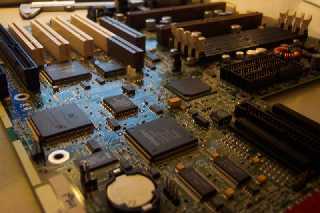

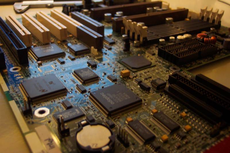

Prompted by a post a few days/weeks ago I looked up a project I worked on a
few years ago
This is an actual mainboard (Intel DK440LX, see pic)
I stopped working on it because I couldn't figure out how to make the
printed tracks and the silkscreen (the white prints). I tried scanning and
photographing it but it didn't come out good enough. And handcoding all the
wires and texts is a bit too much work
Ideas, comments, complaints etc welcome
Ger
Download 'dk440lx-001.jpg' (85 KB) Download 'dk440lx foto.jpg' (66 KB)
Preview of image 'dk440lx-001.jpg'
Preview of image 'dk440lx foto.jpg'
