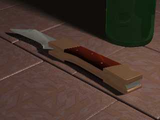

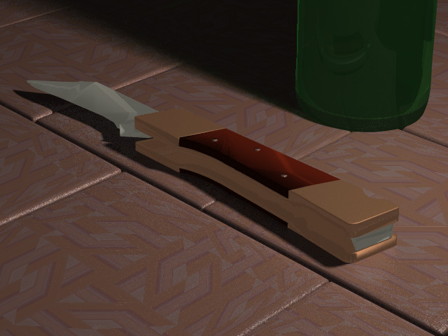

Ok, so thanks to Jim Charter, I've managed to get somewhere with my
lock-knife using Wings. It's not perfect as I can see some edges that
I've missed on the blade and the lower brass component, and the wood
piece. The texturing needs attention too. With Wings, I think it's a
matter of keeping it simple and finding the right procedure.
    ~Steve~

From: St
Subject: Re: [Wings Q] 2 small .jpgs...
Date: 20 Jan 2004 23:38:02

From: Jim Charter
Date: 21 Jan 2004 00:53:15
Message: <400e13cb$1@news.povray.org>
Cool.  And I see you've put bevels on the upper edges as well as the
corners!
From: Jamie Davison
Date: 21 Jan 2004 14:44:47
Message: <MPG.1a78e70e457a584e989d48@news.povray.org>
In article <400dfd00@news.povray.org>, dot### [at] dotcom says...
I find that true with most modelling.  Ignoring fancy shiny new features
in favour or the most old fashioned but efficient method you can think
of has got me out of many a problem.
The brass texture looks closer to copper/gold, and you might want to
drop the ambient value on it a bit.
