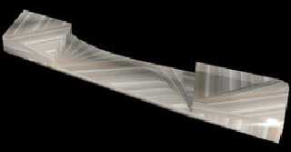

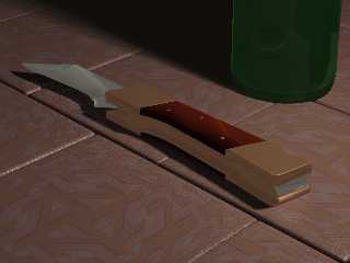

I'm trying to model my old brass and wood lock-knife using Wings but
I'm getting problems with bevelling the corners at both ends of the
upper brass component. In the PoseRay wire frame image, you can see
where I've cut and then bevelled the corners - but I'm finding that
when you do this, it somehow connects to other points, leaving
invisible, (but physical) unselectable edges. The problem with this is
that you can see some of these edges when rendering in Pov. They break
the surface up, and most notable when using reflection. Amazingly
though, when using T_Stone14, Pov shows this problem quite well, as
you can see in the second image.
   Am I doing this wrong? Is there a better way to produce a rounded
corner in Wings? If not, how do I get rid of those extra edges so that
I can have flat surfaces?
   Thanks.
   ~Steve~
Download 'poseraywireframe.jpg' (8 KB) Download 'povoutput.jpg' (5 KB)
Preview of image 'poseraywireframe.jpg'
Preview of image 'povoutput.jpg'
From: Jim Charter
Subject: Re: [Wings Q] 2 small .jpgs...
Date: 18 Jan 2004 14:40:21
Message: <400ae125$1@news.povray.org>
If you could mail me the pre- and post-bevel .wings files I'll try
playing around with it.  Can't promise I'll come up with anything though. :)
-Jim

From: Hugo Asm
Date: 20 Jan 2004 07:48:49
Message: <400d23b1@news.povray.org>
If I understand the problem correctly, you don't want this multi-coloured
shape in POV-Ray, and you're trying to get nice, bevelled edges. The many
nuances of grey that you see in the POV-Ray rendering, are the result of
"normal interpolation". Maybe you already know this, but let me try to
explain for those who are not sure:
In Wings (and most modellers and renderers) every point in 3D-space has an
additional vector stored: the normal vector. This vector is used to enhance
the "smoothness" of surfaces, giving the impression that the model consists
of far more vertices (points) than is really the case. For example, a grid
of 2*2 points (vertices) will usually look very flat - like a rectangle - as
you can imagine. But, simply by adding 2*2 normal vectors, the surface of
the rectangle can be 'bend' so that it looks more like there was hundreds,
or even thousands of vertices between the edges. This is a well-known trick,
and well-used in 3D games today, and is also used in high-quality 3D models
as seen in movies. Rather than having a model with thousands of points very
close to each other, we use model that only consists of the most important
points, and the rest is "interpolated". It saves a lot of memory and is
faster to render. Note however that it does not *really* bend of surfaces.
It just gives a false impression that they're bend, and if the trick is
overly used, it becomes very visible and bad looking.
Your model is rendered with normal-interpolation because that's the default
setting. The normal vectors are calculated automatically by Wings and
exported in the mesh2 file. But you shouldn't give up all control to Wings -
or any other modeller. You need to keep the principle of normal
interpolation in mind, when you model... That is, if you want to *use*
normal interpolation.
But it's really very simple, once you understand the principle: Every normal
vector is automatically produced by averaging the nearby points (vertices).
There just have to BE some nearby points and for best results, they should
not be sharp edges. In other words, they should not have a very different
curvature; then the "normal interpolation" becomes too visible and begins to
look bad.
Boiling this down to a simple rule: Ensure your mesh has a good amount of
points to help the normal-interpolation. For best results, don't use too
many 3-point faces (triangles). Best results come from 4-point faces
(polygons) that look like rectangles (where all 4 edges have roughly the
same length) but there is no strict rule! But it's a good idea, in many
ways... Doing this will also solve the problem you might have with bevelling
the edges. Sometimes the bevelling feature will behave strangely is the
model is not modelled .. "correctly".
Sorry if I wrote too much nonsense. :o)
Hugo

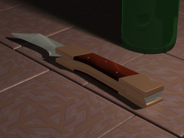

From: St
Date: 20 Jan 2004 23:16:00
Message: <400dfd00@news.povray.org>
Ok, so thanks to Jim Charter, I've managed to get somewhere with my
lock-knife using Wings. It's not perfect as I can see some edges that
I've missed on the blade and the lower brass component, and the wood
piece. The texturing needs attention too. With Wings, I think it's a
matter of keeping it simple and finding the right procedure.
    ~Steve~

From: Jim Charter
Date: 21 Jan 2004 00:53:15
Message: <400e13cb$1@news.povray.org>
Cool.  And I see you've put bevels on the upper edges as well as the
corners!
From: Jamie Davison
Date: 21 Jan 2004 14:44:47
Message: <MPG.1a78e70e457a584e989d48@news.povray.org>
In article <400dfd00@news.povray.org>, dot### [at] dotcom says...
I find that true with most modelling.  Ignoring fancy shiny new features
in favour or the most old fashioned but efficient method you can think
of has got me out of many a problem.
The brass texture looks closer to copper/gold, and you might want to
drop the ambient value on it a bit.

From: St
Date: 21 Jan 2004 17:42:36
Message: <400f005c@news.povray.org>
"Jamie Davison" <jam### [at] dslpipexcom> wrote in message
news:MPG.1a78e70e457a584e989d48@news.povray.org...
my
that
wood
a
features
think
   Lots of shiny stuff in Wings though - have you tried it yet Jamie?
  I think Wings 3d is made and geared-up for producing very complex
modeling - you just have to learn the simple commands (menus or hot
keys) first. Things can happen fast in Wings, and you can find
yourself backtracking and using 'undo' a lot, which isn't a bad thing.
  Yes, it was Gold_2A with the ambient dropped a fair bit already.
I've tried the brass textures and for some reason, I can't get it
right with those.
> On a side not, I've looked at modelling one of my knives a few
times,
> but been scared off by all the curves.
> It's one of these :
> http://www.buckknives.com/catalog/detail/225/223
> Got it about twelve years ago and used it for field work, sample
> collection and crude dissection during my degree.
  That's nice. Mine was for fishing and was a gift for my eighteenth
birthday, which was ..err... twenty-two years ago. Sugar.  :(
> Still has the nigh on razor edge I put on it about nine years ago
when I
> put it away.
   After doing 'what' with it, Jamie?   ;)
    ~Steve~
> Jamie.
