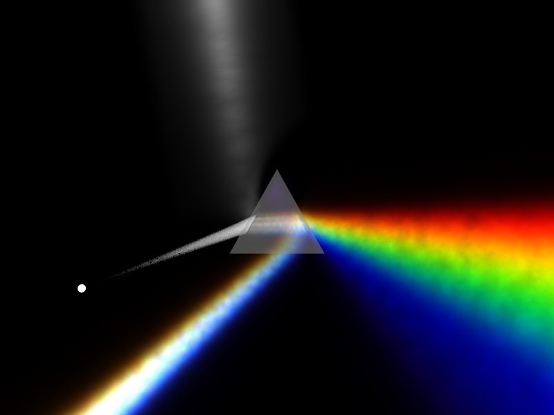

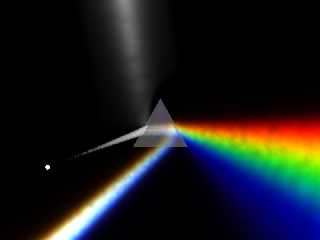

Point light in sphere with hole cut in it for light
source; a spotlight does odd things (small image)...
the area of the spotlight is visible through the
transparent surface...not sure why that is...
Tim Cook
Version: 3.12
Download 'prism_spotlight.jpg' (7 KB) Download 'prism.jpg' (24 KB)
Preview of image 'prism_spotlight.jpg'
Preview of image 'prism.jpg'

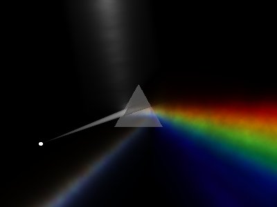

From: Hughes, B
Subject: Re: Prism.
Date: 28 Oct 2003 12:25:26
Message: <3f9ea686@news.povray.org>
"JC (Exether)" <no### [at] spamfr> wrote in message
news:3f9e9406$1@news.povray.org...
> I remember someone (I think it was Gilles but I'm not sure) reporting
> that parallel lights where not working properly with media and
> reflections. It might be the same with spot lights.
> It seems that you're a fan of pink floyd aren't you ?  :-)
Well, I know I sure am!
I checked with a scene of the same kind here and only saw the artifact
during one of the test renderings. It could just be a photon spacing or
count issue, or media samples. However, as you can see from this attached
image the rather mundane settings I ended up with seem to do okay.
There are two light sources, the spotlight (radius 3 falloff 4) and a dim
distant room light. The dispersion is at 1.2 with default samples. The media
is scattering type 1 with a 0.1 color value and extinction of 0 (used only
for box containing only the prism and spotlight) and no other parameters.
Refraction ior 1.5. Photons spacing 0.03 having media 50,1.
Do you have a media for both room and prism? That could be a media samples
and even an intervals issue.
Bob H.
http://www.3digitaleyes.com
Download '-_.jpg' (6 KB)
Preview of image '-_.jpg'
From: Tim Cook
Subject: Re: Prism.
Date: 28 Oct 2003 12:47:29
Message: <3f9eabb1$1@news.povray.org>
I have two separate prisms; the one that's doing the refracting
has no_image 'cuz it takes forever to render otherwise, the
one that's visible is a cheapo materialed copy in front of that
to be a visible prism.

From: Hughes, B
Subject: Re: Prism. A photons artifact?
Date: 28 Oct 2003 17:04:23
Message: <3f9ee7e7@news.povray.org>
"Hughes, B." <omn### [at] charternet> wrote in message
news:3f9ead5b@news.povray.org...
> "Tim Cook" <z99### [at] bellsouthnet> wrote in message
> news:3f9eabb1$1@news.povray.org...
> Hmmm, interesting. Well, could it be the global settings max_trace_level
> needing to be higher than the default of 5 surfaces?
I should have also said global settings *photons* block max_trace_level too,
I guess, but I'm thinking it has nothing to do with the problem.
Anyway, reason I'm back replying to myself here is that I thought I had
stumbled upon the reason I was either seeing or not seeing the same artifact
you had gotten. Then it turned out *not* to be the answer, which was using
photon blocks in the lights, versus not using them and letting defaults
work.
Fact is, I see the same artifact now after having made several changes in
the camera, lights, prism shape, etc. I'll certainly let you know if I find
out the exact reason for this happening, but it's slow going to test render
at a good size. And besides it's confounding me, making matters worse. That
other image I had shown before wasn't antialiased or retouched in any way,
just so you know.  :-)
Bob H.

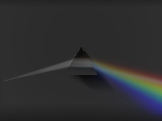

From: Marc Champagne
Subject: Re: Prism. - 2 attachments
Date: 28 Oct 2003 22:15:05
Message: <Xns9422E1D3C73A5POVMIKA@204.213.191.226>
Tim Cook <z99### [at] bellsouthnet> wrote in
news:3f9de495@news.povray.org:
I did one too, but I didn't use media.
Marc Champagne
marcch.AT.videoSPAMNOTtron.DOT.ca.invalid
Montrea l, Canada
Download 'Photon.Party2.jpg' (24 KB) Download 'Photon.Party1.jpg' (12 KB)
Preview of image 'Photon.Party2.jpg'
Preview of image 'Photon.Party1.jpg'
From: Hughes, B
Date: 29 Oct 2003 00:10:32
Message: <3f9f4bc8@news.povray.org>
"Marc Champagne" <marcch.AT.videoSPAMNOTtron.DOT.ca.invalid> wrote in
message news:Xns### [at] 204213191226...
Could've fooled me. And the more I look at it, I can't imagine that is only
light shining on a background surface or something.
Back to the artifact problem... I sure had narrowed the thing down enough to
convince myself it was due to reflection, having forgotten I used that only
after I posted my image showing it didn't have the spotlight lines crossing
through the prism. Now that doesn't seem the answer either.
I finally got my test scene back to the original one, close enough that the
artifact disappeared, but it seemed to be because I used 'media 50,1' in the
global settings photons. And also without reflection. Yet, that was proving
to be the wrong assumption too. When I changed the spotlight radius to 2
instead of 1 it went away, so I figured it must be something about the very
small radius or at least both that and falloff being nearly as small.
Well, a lot of trial and error later, I'm still a bit mystified. It could be
mostly the spacing value changes I've used. At this point I couldn't be
sure. It's like theirs a sweet spot among all the parameters, which is about
as good an answer I can give about it. One thing is certain, and that'd be
to say variations really wreak havoc on the way the resulting media+photons
appears. In turn, this all means it probably isn't a program bug if one way
of rendering is okay. I suppose not, anyhow.
Bob H.
