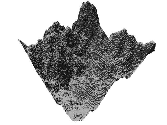

I've been busy with IRTC voting the last week or so, but I'm still very
interested in doing this. Hugo, If you'd still like to compare, I have
attached a height map which I have adapted from something I found on the
web. I have also attached an image of how that map would look as a
standard height field at infinityXinfinity resolution. As you can see,
there is some good shape there, but a lot of need for smoothing. Let me
know if you would still like to compare a few techniques. I have found
that mine still needs a little further development due to precision
problems causing trouble when refining steep areas. I should have that
taken care of by the end of this week, however.
If anyone else has a technique which might help, I would like to see
your results as well. The point is to make a large height field from
this small image map, so enlarging and smoothing the map is not allowed.
Here's the scene file I used for this demo to show contrast, the light
source will need to be adjusted to best show our nice looking results.

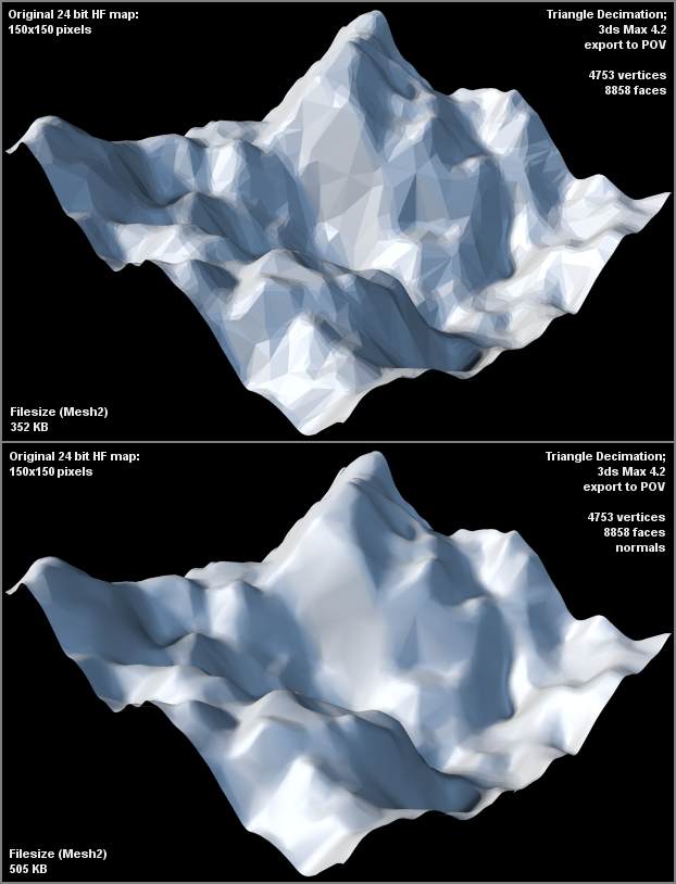

Well I took the map into 3dsMax  (I recently have access to it)  without
preprocessing. However, to obtain any reasonable results from triangle
decimation, there has to be some removal of 8-bit artifacts. I did exactly
as I explained in my last post. The alternative is I can't solve the task.
But I guess I've broken your rule.
What I did was create a plane of 500*500 vertices. Then I displace them with
the hf_map of 150*150 pixels. Then I relaxed the angles between faces, but
because the plane had a better resolution than the original map, I reduced
the loss of details. Finally I applied mesh optimation. Without smoothing /
relaxing the mesh the optimation algoritm would try to keep all the
"stepping artifacts".

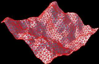

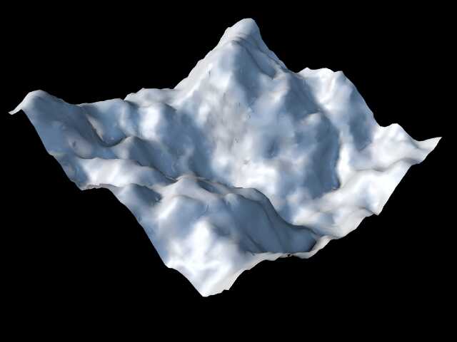

Two pictures here. The first picture is the POV mesh made directly from
the map data. It can be seen that there is more detail, especially on
the steep areas, than with the Max mesh. The Max mesh does have the
"advantage" that with a given number of vertices, a greater percentage
of those will be on the curved parts of the mesh. The POV mesh, however,
has an even greater advantage in that all of the vertices are evenly
spaced and all of the triangles close to the same size. This gives
plainly nicer smoothing normals even in the less dense curved portions.
It would actually be simple to add more vertices to the curved portions
in the mesh, but I tried to get as close to the vertex count in the Max
mesh as possible.
Onto the second picture. The other, larger advantage of the POV mesh's
having its vertices evenly spaced is that further shaping can be done.
The Max mesh is essentially "dead." The second picture is the first mesh
with an additional movement applied (points to whomever can guess the
nature of my "cragginess" filter). There are a few triangle artifacts in
the second, but this is only due to my having produced it half455edly. I
could in the very least retriangulate the quads and make the second mesh
much nicer, but even that would not be necessary on anything but a very
course mesh like this.

I'm impressed if your version contains roughly the same amount of vertices
as mine. There are more details left in yours, and it's an advantage with a
mountain-like HF like this. Can we get a version without normals?
Great work.

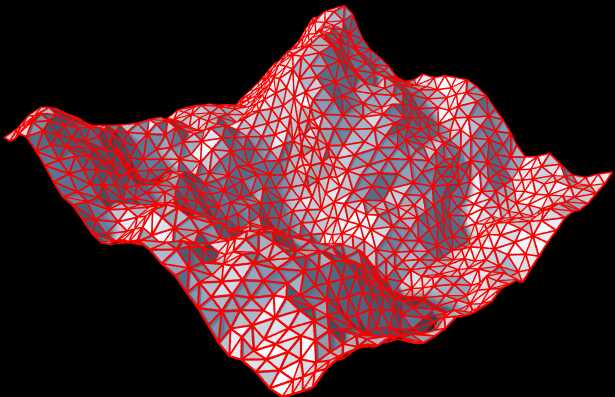

The wire I have attached probably shows it better than I can tell it. As
you can see, even the faces on the steep edges are shaped nicely due to
the faces' vertices being no more farther apart than the vertices of the
faces on the horizontal areas. As you can see, it would even be simple
to form overhangs in this landscape by moving the vertices in the
vertical or near vertical areas.

I attached a low resolution wire below, but it's not terribly
interesting, as few changes in resolution were needed due to the
relatively non-steep inclines. This isn't a great example because the
standarh height field algorithm could have handled this one fairly well.

Oh, now it becomes clear! Very clear indeed, and this is surely an
improvement (once again) to the internal height_field (though it's coded in
SDL). What do you call this algoritm?
> Btw: How did you like the jagginess filter?
If you mean the "cragginess" filter I think your code outputs a clean
result, considering there are jpg artifacts found in the original bitmap. I
don't know how you do this. Once I coded a convolution matrix in SDL (for
guassian blur) but it was terribly slow. You're probably doing something
completely else?
Greetings
Hugo

What I did was pretty simple. I just sort of pinched in the shaded parts
of the map in order to give a sharper edge between the light and dark
sections. The same technique could be used to form a cave.
