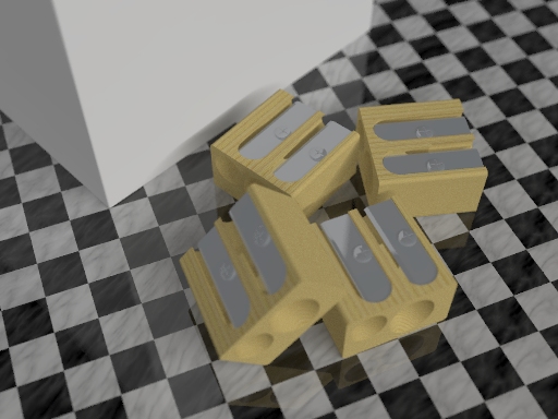

Hi there,
have been working on this image some weeks ago, but never posted it. I think
it looks rather well, but it ain't perfect yet. So if anyone knows what can
be improved, i would love to know.
JWV
PS: i know i used to much focal blur...
Download '2.jpg' (98 KB)
Preview of image '2.jpg'
From:  Light Beam
Subject: Re: pencil sharpeners [WIP?] (98 KB)
Date: 19 Jun 2003 13:13:57
Message: <3ef1ef55@news.povray.org>
No... the focal_blur is enough but I think the focal_point must be set
lower...
From: JWV
Date: 19 Jun 2003 13:23:27
Message: <3ef1f18f@news.povray.org>
> lower...
you mean, more to the foreground? If so, i agree (otherwise i might agree as
well :-))

From:  Light Beam
Date: 19 Jun 2003 13:33:42
Message: <3ef1f3f6@news.povray.org>
as
> well :-))
Yes, I mean also more to the sharpeners !  ;-)
From: Tek
Date: 19 Jun 2003 15:08:01
Message: <3ef20a11$1@news.povray.org>
Looks good so far.
Are the sharpeners made out of wood? It looks a bit grey and plastic at the
moment. It might look better if you rotated it so the grain doesn't line up with
the sides of the sharpeners. Also the lighting looks a little too even, try a
stronger contrast between the light and shadows because at the moment things
look a little flat.
Tek

From: JWV
Date: 19 Jun 2003 15:19:36
Message: <3ef20cc8$1@news.povray.org>
the
up with
Yes, brown part is made out of wood, and the actual knives are made out of
metal. I will rotate the texture by 5 degrees or so, and see if it looks
better.
things
> look a little flat.
At the moment there are 20 lights (one light rotated around the y-axis
1/10th of a degree 20 times by a loop).
I will try an arealight to see if that works better.
Thanks for the tips, they realy help.
JWV

From: Ross Litscher
Date: 19 Jun 2003 15:55:00
Message: <3ef21514$1@news.povray.org>
i don't get a good feeling of scale when looking at this. If a pencil
sharpener is about 1 inch in size, then the floor tiles are super small, and
then what is this big block on the left? it would be about the size of a
chinese food takeout carton, but it looks like a wall.
I think a few good desk items and a more natural floor or table surface
would compliment your nicely detailed pencil sharpeners. and some pencils!
so i guess my suggestion is to improve the environment. the sharpeners are
looking pretty good (thought all mine growing up where either metal or
plastic)

From: Tek
Date: 19 Jun 2003 16:30:17
Message: <3ef21d59$1@news.povray.org>
"JWV" <jwv|at|planet.nl> wrote in message news:3ef20cc8$1@news.povray.org...
> better.
The problem is the sides appear completely flat coloured. Some turbulence might
help too. The metal material on blades look about right.
That sounds like a fairly unnatural lighting setup. I recommend an arealight
above and to one side, to pick out more details, and maybe make it slightly
orange to simulate a light bulb. Just a suggestion :)

From: JWV
Date: 19 Jun 2003 17:21:48
Message: <3ef2296c@news.povray.org>
light source is now a area light
and
the pencil sharpeners are 1 inch size, the big white thing on the left is
just there to fill the scene.
the tiles need some work, I added a sheet of paper with 5 mm squares to give
a better feling of scale.
will work on that tommorow....
JWV
PS new version will be posted tomorow first thing in the morning. need to
sleep now :-).
