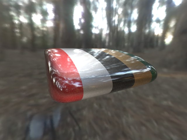

For anyone who hasn't been following the other thread: I can't illuminate my
metallic paint using only radiosity, as it relies on specular highlights, which
meant I couldn't light it using HDR...
...but now I've found a way round it: Here the object is lit by a set of light
sources distributed round a sphere, with their colours sampled from the HDR
image. It's very effective and it means I can just change the HDR and it looks
right. I've not used radiosity, but I guess to combine this with radiosity you'd
need to turn off the HDR sky sphere and save the radiosity, then turn it back on
for the final render, otherwise the light sources will combine with radiosity
from the sky sphere and cause twice the illumination in the scene.
Anyway, the pictures show the paint in a variety of HDR environments, and the
beach and campus pictures are using a much more metallic type of paint (90%
metallic, compared to 60% in the other pictures).
The metallic paint is the same code used for the other picture, which is on
p.b.s-f. I can provide the source code for the light dome trick if anyone wants
it, but it's pretty straighforwards and my version is a little messy.
You like? :)
Tek
http://www.evilsuperbrain.com

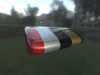

From: Tek
Subject: Re: Metallic paint - HDR renders
Date: 15 May 2003 17:24:40
Message: <3ec40598@news.povray.org>
I discovered HDR looks a *lot* better with assumed_gamma 1, so I've rendered a
few more versions. With this gamma setting there's not so much saturation on the
bright points, so we can have light and dark things in the same scene more
realistically.
Tek

From: JWV
Date: 16 May 2003 03:35:47
Message: <3ec494d3@news.povray.org>
I think you should leave out the glitter on the black part of the object.
news:3ec40598@news.povray.org...
rendered a
on the
> realistically.
> Tek
From: Tek
Date: 16 May 2003 13:35:56
Message: <3ec5217c$1@news.povray.org>
"JWV" <jwv|at|planet.nl> wrote in message news:3ec494d3@news.povray.org...
I agree, that occured because I created the glitter effect with only one light
source, but now it's surrounded by a dome of lights the glitter appears all over
the surface. It should be possible to refine it without making it look less
glittery.
Tek

From: Tek
Date: 16 May 2003 17:09:34
Message: <3ec5538e$1@news.povray.org>
The backgrounds are HDR (high dynamic range) photos from Paul Debevec's site:
http://www.debevec.org/Probes/
They're rendered using MLpov, a modified version of POV3.5 which has support for
HDR: http://pov.monde.free.fr/mael/mlpov081eng.html
I started using HDR just the other day, but it's taken me only a couple of
evenings to get these kinds of results.
Tek
> light
> HDR
> looks
> you'd
> back on
> radiosity
> the
> (90%
> on
> wants
> > You like? :)
> > Tek
