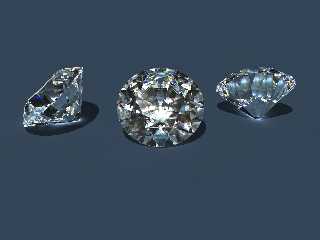

From: Michael Goldshteyn
Subject: Marc's diamonds high res with some mods (lossy JPEG 2048x1536)
Date: 26 Mar 2003 17:19:52
Message: <3e822788@news.povray.org>

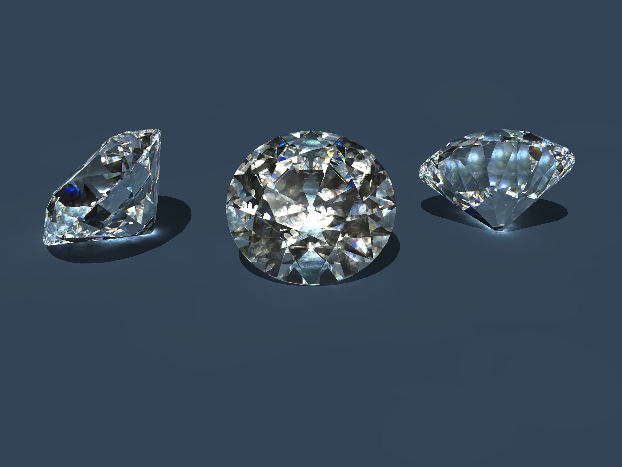

finish changes:
    finish   { ambient    0.1
               diffuse    0.4
               specular   0.5 // 0.8
               roughness  0.002 // 0.003
               phong      1
               phong_size 300
max_trace_level upped to 100
Traced at 2048x1536 with +a0.3 (+am and +r at defaults)
Download '3diamonds.jpg' (197 KB)
Preview of image '3diamonds.jpg'
Subject: Re: Marc's diamonds high res with some mods (lossy JPEG 2048x1536)
Date: 26 Mar 2003 17:38:56
Message: <3e822c00$1@news.povray.org>
Here's a preview:
Download 'pear.jpg' (16 KB)
Preview of image 'pear.jpg'
From: Andrew
Date: 26 Mar 2003 19:38:55
Message: <3e82481f$1@news.povray.org>
Nice picture!
Out of interest, what are you using for the environment - ie the stuff
we can't see but is getting reflected/refracted in the gems?
From: Marc Jacquier
Date: 27 Mar 2003 02:08:50
Message: <3e82a382@news.povray.org>
Wow! very impressive!
Would you mind uploading the png version and give us a link, so that we can
see it without loss?
Marc
From: Bruce
Date: 27 Mar 2003 03:34:39
Message: <3e82b79f$1@news.povray.org>
> finish changes:
>                diffuse    0.4
>                specular   0.5 // 0.8
>                phong      1
>                phong_size 300
Waouh... Really wonderful! Could you put the source code somewhere, I
really wonder how you can have such a wonderful result!
Bruce

Excellent !
Date: 27 Mar 2003 09:00:32
Message: <3e830400$1@news.povray.org>
You can grab the original source from povray.text.scene-files (Mika Diamond
by Marc Champagne). I don't want to take much credit for this scene, since I
only made the changes listed below and zoomed in a little (z*1.5). Let me
warn you that unless you have a top of the line machine, are willing to
settle for tiny resolutions, and/or are willing to wait for many hours
(days?), don't expect to produce the picture in the above post. As I think I
already mentioned the posted picture took somewhere in the neighborhood of
22 hours on a 2.4GHz XEON with 1GB of RDRAM. Of course 1024x768 / no AA
renders can be done much faster, but they still take time. In any case, my
next project, a pear shaped diamond solitaire, is currently rendering and
should be done by this coming Monday. It's progressing much more slowly
(raised max_trace_level to 110 and finish params have been modified
further), but it is going to be arguably even more awe inspiring than the
above post. I will post its source when the render completes and the image
is posted.
P.S. Once again, a real thanks to Marc Champagne for inspiring me with his
original image (and source file)...
Date: 27 Mar 2003 13:25:10
Message: <3e834206$1@news.povray.org>
"Andrew" <ast### [at] hotmailcom> wrote in message
news:3e82481f$1@news.povray.org...
> Nice picture!
Absolutely nothing, it's all in the dispersion...
