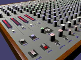

For this IRTC round the operative keyword is "#macro"!  Not one of my
stronger subjects so far, so I'm working on improving my programming. This
is my first real test at complexity... macros calling macros calling macros
etc...
It's not architecture, I decided to stick to something I was familiar with.
Further proof that you can take the musician off the road, but you can't
take the road out of the musician... guess I still miss the smell of contact
cleaner and belden cable :-o
Needs better textures, any other comments or critiques?
RG - oops, it's too long for a sig
Download 'mixer.jpg' (79 KB)
Preview of image 'mixer.jpg'

I like it!
I had a try at modelling a mixing desk (Behringer 3282) some years ago, but
with Moray, no macros.
Is yours a Yamaha? they use colors like that.
I'd see the pot knobs a little higher, so that we can see nuts and washers.
Same thing for faders.
Talkback XLR looks strange: holes 1 and 2 should be on the same diameter and
not on an equilateral triangle
Phone outputs have octogonal nuts? I never ever saw that.
Errrrr... group 1 is clipping while its fader is cut ;-)
If it is not from a real model, I'd put low levels of bargraphs green, just
below 0dB yellow and red above ...
BTW they miss a scale.
But after all it is a workshop for macros, but a good start for a desk
image... may be in may, after IRTC round ends?.
Marc
3e7296af@news.povray.org...

Rounded Cones may further improve the work....

Take a look at the instruments in my gallary for help with ideas like dirt
and how to make things look real and when they do not.
Hope it helps.

looks good. i don't have a mixing board, but the knobs on my nord lead have
grooves in them for better grip. also, the inputs on Phones 1 and 2 don't
look deep like holes. oh, some of the knobs look like they are missing the
little line on top. maybe thats just an image resizing or AA issue.
i have not seen many mixing boards, but i've never seen one with pastel
knobs :)

I have Yamaha, Samson & Tascam, but for this I used the parts & colors that
looked easiest of all 3. Same for the layout, whatever looked easiest to
program.
The main macro takes #of input_channels & #of output_channels so far. But
the
idea is that I could specify different layouts to build different types of
boards.
(Not different brands, but say a recording board, a board for large clubs,
or a
small powered mixer.)  The main macro then calls the builder macros to build
the
board from a number of part building macros.
and
Heh heh, modeling was low priority, was working on arguments & scope  ;-)
Damn drummers!
Still working on that, its a texture and haven't figured how to change it on
the fly
yet.... maybe a texture array...
Only on analog... my Tascam is digital & it stops at 0db. Weird.
Hmm, have to try it. It does kinda have that knob/dial testosterone
appeal...

Haven't tried the rounded shapes yet, I'll have to look. Or I suppose I
could
just add toruses to these...
Cool! Is that all POV?  I like your toggles & jacks!
Good idea...
You're right! I forgot to difference the console. Thanks for noticing!
AA I think maybe helped by lighting.  Line is there.
>knobs :)
Funny, last time I bought a board about 6-7 years ago, they were all like
that,
very colorful.  I looked at some today at a music store & they were all in
basic
black, gray, stainless steel & aluminum. Occasionally a somber blue.  Deep.
Thanks for the comments! If I get time I'll try some out & post an update.
Now to convert boards, knobs & dials to walls, doors & windows & see if
there's an IRTC entry in here somewhere!
RG

Yes I know: in my band we are 3 musicians and 1 drummer ;-)
just
on
> the fly
Or a #switch/#case/#range directive (doc 6.2.6.3)
Because digital converters can't digitalize levels higher than their bit
resolution allows, so going above 0dB would result in harsh clipping but I'm
getting off topic :)
> appeal...
LOL
> could
And cylinders to fill inner hole of toruses
Marc

OY!!!  I must have read that section, but I completely spaced on the #range
part!  That will not only work there, but will simplify a couple of other
switches as well!
Thanks for the pointer!
