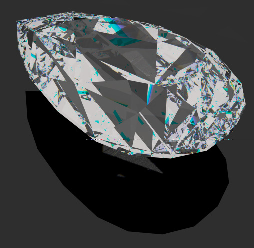

Check this pic, I did it a week ago with the pear shape and it completely
sucks. Among other things, something went completely wrong with the
dispersion and I just couldn't get it working. And I decided to forget about
the thing anyways.

From: Greg Edwards
Subject: Re: Lucy in the sky with diamonds...
Date: 14 Mar 2003 22:05:12
Message: <16xu93graq0aq.kik255m9clkv$.dlg@40tude.net>
> the thing anyways.
You're getting those little cyan spots too? WHat OS did you render this
under? It seems like some sort of a bug in the windows compile of POV. By
downloading the source and re-compiling POV under VC++ I could fix this bug
(no changes to the source). I made a post to p.p a little while ago about
this.

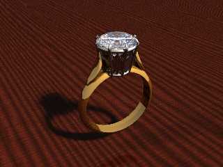

Subject: HOT HOVERIN' ROCK! ;)
Date: 15 Mar 2003 18:03:17
Message: <3e73b135@news.povray.org>
"Andrew" <ast### [at] hotmailcom> wrote in message
news:3e723da3@news.povray.org...
> > news:3e722e53$1@news.povray.org...
> > > You're using the correct IOR for diamond, right?
> Then change the ior of the glass to 2.47 (or whatever diamond really
is)
> and
> re-render.  You'll see that the bright spots on the ground are no
longer
> bright.  This could be the problem with your diamonds.  Have you
tried
> setting the ior to 1.5 or so, just to see what a glass "fake" would
look
> like?
      Yes, tried that last night, and you were right, the bright spots
disappeared, but the diamonds looked more like Blue Topaz than
diamonds, but REALLY GOOD Blue Topaz!! (Because of my blue sky_sphere)
   (Note to self: must remember this!)
> Thanks for the heads-up on gemcad - sounds useful.  Very useful in
fact!
   My pleasure, "Anything to help anyone" would be my motto of choice.
   So, what do you reckon to the attached now?
   With this image, I stayed with IOR 2.41 in the end.
      ~Steve~
Download 'h-d.jpg' (187 KB)
Preview of image 'h-d.jpg'
From: Andrew
Subject: Re: HOT HOVERIN' ROCK! ;)
Date: 16 Mar 2003 07:47:55
Message: <3e74727b@news.povray.org>
Now that's looking pretty good!  I'm going to have to try some gemstones
out myself...
From: St
Date: 17 Mar 2003 13:46:26
Message: <3e761802@news.povray.org>
news:3e74727b@news.povray.org...
gemstones
> out myself...
    Thanks! I'm not too happy with those blotches next to the sharp
edges (at the bottom), of the shank though. I'm not sure if it's a
sPatch thing or a texture thing at the moment...
   I'm going to try a ring with either eight or ten diamonds next,
surrounding an oval sapphire, or perhaps an emerald. I'll see if I can
put it in a pseudo velvet-lined ringbox too. That should be fun!  ;)
 Yes, give it a go, there's a sort of nice feeling being able to
produce a diamond that's FREE!
     (...and you can make it as big as you want!)    :)
