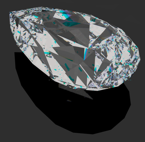

Check this pic, I did it a week ago with the pear shape and it completely
sucks. Among other things, something went completely wrong with the
dispersion and I just couldn't get it working. And I decided to forget about
the thing anyways.

From: Apache
Subject: Re: Lucy in the sky with diamonds...
Date: 14 Mar 2003 17:32:41
Message: <3e725889@news.povray.org>
If you want diamonds to look like diamonds do and if you also want to use
the right shapes, your IOR should be set to the diamond's.
And for those interested in more info and dxf files, go to
http://www.3dlapidary.com/
From: Greg Edwards
Date: 14 Mar 2003 22:05:12
Message: <16xu93graq0aq.kik255m9clkv$.dlg@40tude.net>
> the thing anyways.
You're getting those little cyan spots too? WHat OS did you render this
under? It seems like some sort of a bug in the windows compile of POV. By
downloading the source and re-compiling POV under VC++ I could fix this bug
(no changes to the source). I made a post to p.p a little while ago about
this.
