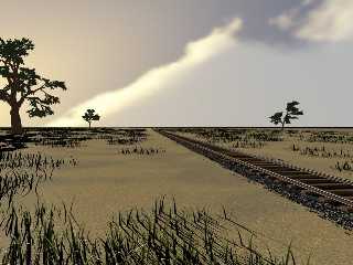

Making a background for my IRTC entry, but can't figure out how to get rid
of the nasty lines on my rr tracks.  Rendering with +a0.05 +am2 made no
difference at all except for driving the render speed down to 7 pps for most
of it :(
This render is with +a0.1 +am2.
Any suggestions?
RG
Download 'tracks.jpg' (70 KB)
Preview of image 'tracks.jpg'

Try a slightly different camera angle, or try making the tracks a little
larger.
-David

Hi.
Nice pic!
I had a similar problem some time ago wich I resolve with this settings
+AM2 +A0.0 +R2 -J
as suggested in the forum.
You might want to try it out. It gets good results, but is SLOW :)
You might want to take a look at the thread:
http://news.povray.org/povray.binaries.images/24275/
I hope this will help.
Best regards.

When I get in these situations I usually render at 2 or 3 times the final size
with either no AA or very low AA settings like +A0.4 +Am2 +R2. Another option,
which looks better, would be to use a very slight focal blur, but this will be
very slower. If you have the ability to render just parts of an image you could
use the focal blur on the rails alone - some of the better POVers routinely
render sub parts of images with different settings and then glue the results
together to create the final image.
Bill P.

I sometimes get better results by using focal blur instead of aa. It
is also sometimes faster. Try something like:
      aperture 0.05
      blur_samples 20
      focal_point <0,0,0> // Whatever you want
      confidence 0.97
      variance 0.005
Alf

At a quick guess, I'd go with Alf Peake's focal blur solution. I certainly
wouldn't go down the route of part-renders cut and pasted. IIRC it
contavenes the IRTC rules ;-) ;-)

Thanks for all the suggestions!  I'll try out JPGargoyle's aa settings, and
play around
with focal blur as Alf suggested (but the creative process has already added
objects
in the background that may make focal blur a moot remedy...)  I'm also going
to try
changing the rail object (currently a flattened cylinder) to a prism to see
if putting a
sharper edge on it helps.
