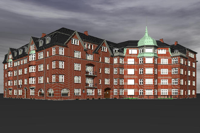

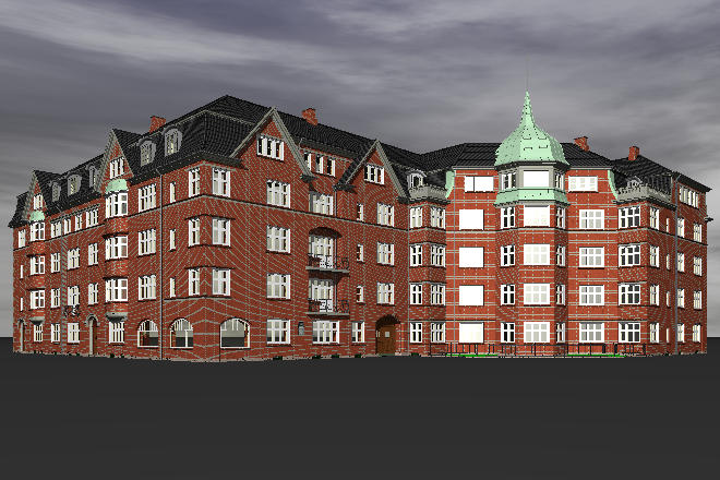

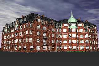

Just thought that you might like to see the difference a field camera makes
to an architectural scene.
Bygning4.jpg is rendered directly from Ib's original code
Bygning4a.jpg is rendered using my FieldCam macro with rescaling turned on
Bygning4b.jpg is rendered using my FieldCam macro with rescaling turned off

From: Greg M  Johnson
Subject: Re: Ib Rasmussen's Bygning4 rebuilt
Date: 14 Jan 2003 11:55:11
Message: <3e2440ef$1@news.povray.org>
Excellent work, but am i correct in assuming there's also some unpleasant
warping of the brick texture even in the last example:  is that actual
warping or a pixelation artifact?
From: Doctor John
Date: 14 Jan 2003 12:21:52
Message: <3e244730@news.povray.org>
"Greg M. Johnson" <gregj:-)565### [at] aolcom> wrote in message
news:3e2440ef$1@news.povray.org...
Just pixellation artefacts, the image should really be rendered at 1500x1000
(and antialiased) for the best results.
I was just showing how my macro makes a difference to an architectural
scene.
John
Run Fast
Run Free
Run Linux
