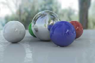

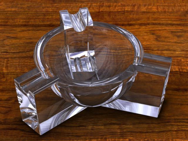

Hi all,
the images made with HDRI have a really amazing lighting.
And as far as I can see there is not so much effort in
setting the scene lights.
So I tried to make a similiar thing. It's a sphere with
a mapped picture for lighting, traced with radiosity of
course.
When I see the result I think there is not much difference
compared to the HDRI method.
So my question:
What is the advantage of HDRI?
Maybe I'm blind...
-C-H-A-R-L-E-S-

Your image is a bit dark. When I look in the glass, I would expect the sky
to be brighter and the road darker (if it's a road) and the table more lit.
This is what HDRI is for. On the other hand I agree, this HDRI thing is a
bit overrated. Some says it's the holy grale! But higher contrasts in
image_maps, used as faked enviroment, is more realistic. With radiosity, I'm
fairly confident it gives a better result than a mere 24-bit image, because
radiosity calculations react to light intensities above 1 (a white rgb)...
But with reflections, the docs says "POV-Ray uses a limited light model that
cannot distinguish between objects which are simply brightly colored and
objects which are extremely bright" therefore we have the
reflection_exponent keyword... So that shouldn't work in favor of HDR, but
I'm not fully certain about it.
Btw, you haven't used interpolation of your image_map, have you?
Hugo
From: Charles Panke
Subject: Re: HDRI, why?
Date: 3 Jan 2003 06:07:51
Message: <3e156f07@news.povray.org>
"Hugo Asm" <hua### [at] post3teledk> schrieb im Newsbeitrag
news:3e1560f2@news.povray.org...
Hi Hugo,
thanks for the clarification.
It's intended like it is.
Right, it was a quick and dirty test.
And the size of the image is very small.
-C-H-A-R-L-E-S-

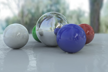

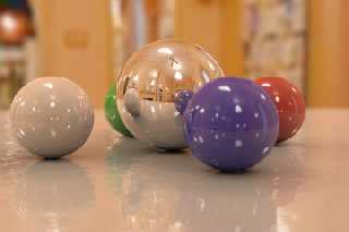

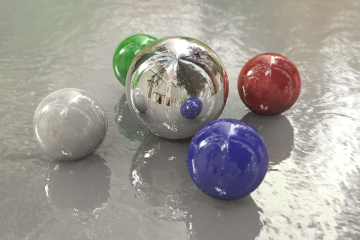

  Because, appart from being almost necessary to create "augmented
reality", it is a very cheap way to fake a complete environment for
close-up shots, including the lighting, with maximum realism.
  Indeed, I've made some more tests with "faked HDRI", this time with
a 255 layers texture. The first layer is the simple image_map with
ambient, and the other 254 are done with a grayscale version of the
same image, using exponential transmit. Not bad results, and very
quick to render (well, not much more slow than a single layer
texture).
Jaime Vives Piqueres

Wow, what did you use as the texture for that table? Or is it image mapped?
Mike

"Charles Panke" <cha### [at] t-onlinede> wrote in message
news:3e15581b@news.povray.org...
   Is it me, or is that table repeated three times in some places??
   Whatever, nice image though.

Jaime Vives Piqueres wrote:
> Not bad results...
Heh, you win!
That is very nice work, but where are the photons?
Could you work a crystal ball into your test scene and show refraction and
reflection working with the fake HDRI environment?
