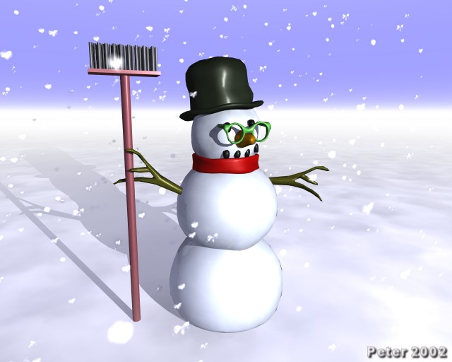

Just fooling around..
Wings3d for modelling
Discs for snowflakes
Fog, sky_sphere, plane and radiosity..
Could've needed another subdivision on the body..
1280x1024 version available if anyone is interested..
-Peter
Download 'snowman.jpg' (45 KB)
Preview of image 'snowman.jpg'

> Hehe, have I inspired you?
:) Yeah! I did the snowman some night last week, and your animation inspired
me to add the snowflakes.
Although your snow looks much more realistic, I belive my snow fits rather
good into the cartoony scene.
One thing that bugs me though, is that some of the flakes look very similar
(you see it clearly in the large version), and they are a bit too round.
Another thing (slightly noticeable in the small version) is that you can see
the outline of the disc if it's in the shadow of the snowman. (Image
attached, PNG because JPEG kills some of it)
It occurs both with and without radiosity.. Here is my macro:

Should I align the flakes towards the camera? I'm thinking trig.. Any
simpler, faster way do this? Align_Trans(), Reorient_Trans().. ?
