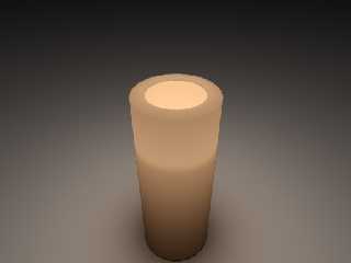

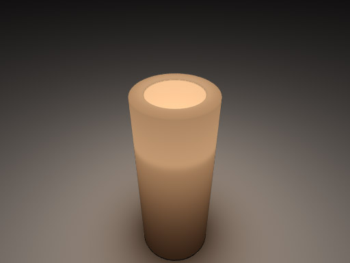

This is an experiment for a larger picture I'm construction.  It shows a
translucent wax candle.  Getting the wax to "glow" without being transparent
is amazingly difficult.   Comments and suggestions welcomed.
JFMILLER
Download 'Candle.jpg' (18 KB)
Preview of image 'Candle.jpg'
How did you do this? Sub-surface scattering or regular textures? It's a
bit tough to judge without the flame, but to me the gradient seems a bit
too sharp where it goes from light to dark. My spontaneous reaction is
that it should be smoother, or maybe that the light part should be shorter.
/ martin

This is more a problem with the "quick-n-dirty" modle I used.  Ther is only
one point lightsource in the seen and as you pointed out no flame.  I was
mor interested in the translucent wax effect.
I tried to use subsurface scattering but it didn't come out right.  By the
time I made the media dence enough to not be transparent I also succeeded in
blocking all the light.
JFMILLER

From: Apache
Subject: Re: Translucent Wax Candle
Date: 4 Dec 2002 12:05:37
Message: <3dee35e1@news.povray.org>
I think the edge is just right. I've seen such sharp edges in real candles.

Thanks for the reference.  I had read your post before starting this project
and it is what gave me the idea.  I missed the part about interior_texture
though so I couldn't get it to work.
The solution shown here is kind of the invers of sub-surface scattering.
There is a transparent outer shell that contains an absorbtion media (white
at the moment) the iner shell is the same object with an opaque,
double_illumnate, no_shadow texture, and brilliance turned down to 0.05.
I'll go back and fiddle with the modle after finals are over and see if I
can get it to work.
Thanks
JFMILLER

From: =Bob=
Date: 4 Dec 2002 13:04:10
Message: <3dee439a$1@news.povray.org>
Nice picture! The translucency is convincing, but
the evenness of the light through the was isn't (to me).
Also, Ithink the melting is too uniform. Wax is kind-of
shiny and I don't see that in the rear opening of the
melted depression, of course no flame yet so
maybe that will come with it? Good lighting!
Have a great day!
=Bob=

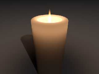

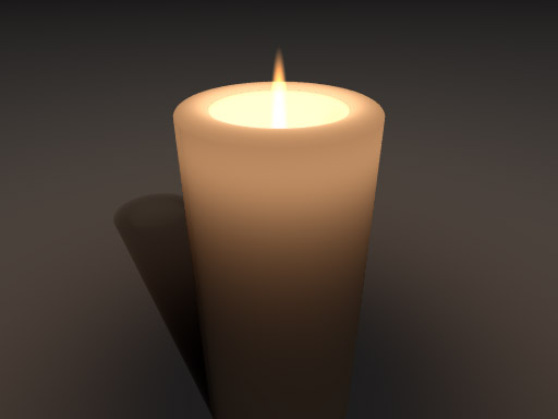

Ok, heres the real next version.  For those of you would cauget the last one
before it was canceled I appologize.
I reduced the wall height for the "melt zone" and made the
bottom more curved to remove the sharp line.  In addation,  I added some
'ior' top the shell which aslo softened the transition.  Other then that, I
added a wick (not visible) and flame and changed the camera angle.  I also
adjusted the media density a bit.
Comments; suggestions?
JFMILLER
Download 'Candle1.jpg' (18 KB)
Preview of image 'Candle1.jpg'
*gyaahhhhhh* *drool*
Can I peek at your source?
Tim Cook
