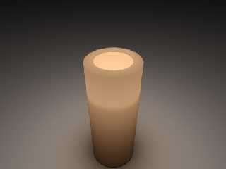

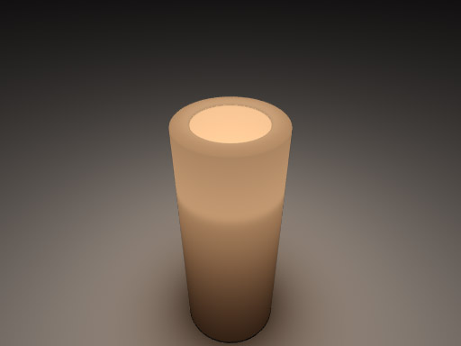

This is an experiment for a larger picture I'm construction.  It shows a
translucent wax candle.  Getting the wax to "glow" without being transparent
is amazingly difficult.   Comments and suggestions welcomed.
JFMILLER
Download 'Candle.jpg' (18 KB)
Preview of image 'Candle.jpg'
From: Martin Magnusson
Subject: Re: Translucent Wax Candle
Date: 4 Dec 2002 01:37:50
Message: <3DEDA2CD.4070908@frustratedhousewives.zzn.com>
How did you do this? Sub-surface scattering or regular textures? It's a
bit tough to judge without the flame, but to me the gradient seems a bit
too sharp where it goes from light to dark. My spontaneous reaction is
that it should be smoother, or maybe that the light part should be shorter.
/ martin
From: jfmiller
Date: 4 Dec 2002 01:53:25
Message: <3deda665@news.povray.org>
"Martin Magnusson" <lov### [at] frustratedhousewiveszzncom> wrote in message
news:3DE### [at] frustratedhousewiveszzncom...
transparent
shorter.
> / martin
This is more a problem with the "quick-n-dirty" modle I used.  Ther is only
one point lightsource in the seen and as you pointed out no flame.  I was
mor interested in the translucent wax effect.
I tried to use subsurface scattering but it didn't come out right.  By the
time I made the media dence enough to not be transparent I also succeeded in
blocking all the light.
JFMILLER

From: Apache
Date: 4 Dec 2002 12:05:37
Message: <3dee35e1@news.povray.org>
I think the edge is just right. I've seen such sharp edges in real candles.
From: jfmiller
Date: 4 Dec 2002 12:57:53
Message: <3dee4221@news.povray.org>
Thanks for the reference.  I had read your post before starting this project
and it is what gave me the idea.  I missed the part about interior_texture
though so I couldn't get it to work.
The solution shown here is kind of the invers of sub-surface scattering.
There is a transparent outer shell that contains an absorbtion media (white
at the moment) the iner shell is the same object with an opaque,
double_illumnate, no_shadow texture, and brilliance turned down to 0.05.
I'll go back and fiddle with the modle after finals are over and see if I
can get it to work.
Thanks
JFMILLER

From: =Bob=
Date: 4 Dec 2002 13:04:10
Message: <3dee439a$1@news.povray.org>
Nice picture! The translucency is convincing, but
the evenness of the light through the was isn't (to me).
Also, Ithink the melting is too uniform. Wax is kind-of
shiny and I don't see that in the rear opening of the
melted depression, of course no flame yet so
maybe that will come with it? Good lighting!
Have a great day!
=Bob=

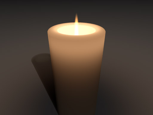

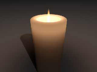

From: jfmiller
Date: 6 Dec 2002 21:43:49
Message: <3df16065@news.povray.org>
Ok, heres the real next version.  For those of you would cauget the last one
before it was canceled I appologize.
I reduced the wall height for the "melt zone" and made the
bottom more curved to remove the sharp line.  In addation,  I added some
'ior' top the shell which aslo softened the transition.  Other then that, I
added a wick (not visible) and flame and changed the camera angle.  I also
adjusted the media density a bit.
Comments; suggestions?
JFMILLER
Download 'Candle1.jpg' (18 KB)
Preview of image 'Candle1.jpg'
From: Timothy R  Cook
Date: 6 Dec 2002 22:49:44
Message: <3df16fd8@news.povray.org>
*gyaahhhhhh* *drool*
Can I peek at your source?
Tim Cook
