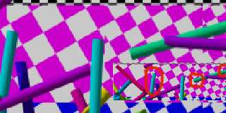

Hi,
It might not be the right group to post a question about an possible render
issue but I wanna post
an example picture.
I have not found any previous discussions about a similar topic, if there is
any, please let me know.
Currently I am writing a short tutorial about anti-aliasing and during the
rendering of several test images, I discovered the effect of bleeding colors
(rough translation from German, sorry). In English, certain color
combinations do not show an quality improvement during rendering with
anti-aliasing. Instead an unwanted color appears. In my example, a dark blue
appears between a light blue and magenta. See the marked area in the
attached image.
After thinking about the algorithms of anti-aliasing I seems pretty clear to
me, that such effect can occur. Anti-aliasing averages colors to find a more
suitable color at edges and so tries to improve the image quality. But the
average between a light blue and magenta is dark blue, even when this means
stressing the edge instead of smoothing it.
I tried both anti-aliasing methods and different settings (deepness,
threshold). A similar effect occurs in all graphics applications during
resizing of images with smart interpolation algorithms. These resizing
algorihms also average colors to deliver better results and therefore get
cought in the same problem.
Does anyone know a way to suppress this strange but quite logical behavior?
Would it make sense to use an averaging algorithm based on HSL instead of
RGB to improve the results? Of course, it could also be a problem without
any solution. Comments are welcome.
Thanks,
Rene
P.S. Sorry for posting a PNG file, but this is the only compressed and well
supported file format that can demonstrate these pixel color problems.
Rene Schwietzke
http://www.rene-schwietzke.de/
Download 'aa-sample.png' (58 KB)
Preview of image 'aa-sample.png'
From: hughes, b
Subject: Re: Anti-Aliasing Problem including sample image (58k)
Date: 26 Nov 2002 18:30:16
Message: <3de40408@news.povray.org>
"Rene Schwietzke" <r.s### [at] reneschwietzkede> wrote in message
news:3de3fb74@news.povray.org...
---snip---
to
more
means
---snip---
behavior?
Good example. Yellow against magenta also looks a little strange to me. And
where the blue checkers are the yellow and light green cylinders darken. If
other programs also do this like you say then it sounds like a holy grail
idea, but maybe a good one anyway.If I only knew how HSL would effect it...

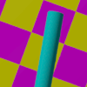

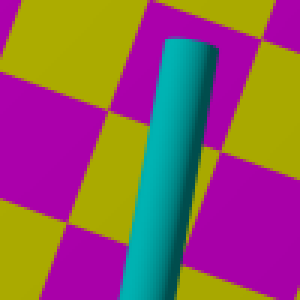

From: Ive
Date: 26 Nov 2002 20:16:56
Message: <3de41d08@news.povray.org>
Thats not completely true. Photoshop uses internal the CIE L*a*b color
format for all image processing and does avoid that unwanted color blending.
L*a*b is also a possible color format for TIFF images but most image
viewers (like IrfanView) do not display this format correctly, maybe thats the
reason that not so many people know about it.
For high quality images, it's the best to render them without AA but twice the
size and then use P'shop to downsample them. See the attached (3x magnified)
examples. One is just POV with +AA0.0 +AM2, the other one is resampled
with Photoshop. If I remember right, ImageMagic works fine with CIE L*a*b,
so maybe it could also be used, but I have not checked this out.
so long
-Ive
Download 'aaTest-POV.png' (7 KB) Download 'aaTest-PS.png' (12 KB)
Preview of image 'aaTest-POV.png'
Preview of image 'aaTest-PS.png'
From: Anders K
Date: 26 Nov 2002 20:36:16
Message: <3de42190$1@news.povray.org>
The problem completely goes away when I gamma-correct your image by 2.2.
Don't tell me that old anti-aliasing gamma bug snuck back in there...
Anders
light_source{6#local D=#macro B(E)#macro A(D)#declare E=(E-#declare
C=mod(E D);C)/D;C#end#while(E)#if(A(8)=7)#declare D=D+2.8;#else#if(
C>2)}torus{1..2clipped_by{box{-2y}}rotate<1 0C>*90translate<D+1A(2)
*2+1#else}cylinder{0(C-v=1).2translate<D+C*A(2)A(4)#end-2 13>finish
{specular 1}pigment{rgb x}#end#end#end-8;1B(445000298)B(519053970)B
(483402386)B(1445571258)B(77778740)B(541684549)B(42677491)B(70)}
From: Anders K
Date: 26 Nov 2002 21:17:28
Message: <3de42b38$1@news.povray.org>
I just checked, and indeed, POV-Ray seems to be antialiasing after gamma
correction. Bad!! This should really be fixed, but as a workaround, you can
render with Display_Gamma=1.0 and then manually gamma-correct the image by
2.2.
Anders

expected an unsolvable problem but the discussion above shows, that it might
be a defect. Could LAB solve the problem as discussed before? It seems to be
fine for Photoshop but it could be protected by copyrights...
Rene
Rene Schwietzke
r.schwietzke<at>reneschwietzke.de
news:3DE48E3B.A056E319@gmx.de...
> The reason is that color blending in POV is based on linear interpolation
> between the different color values in RGB space.  Although HSL color space
> is somewhat different i don't think it would solve the problem.
> I think it would be an interesting feature to add an optional different
> (and more realistic) color interpolation method to POV-Ray, not only for
> antialiasing but also for color maps for example.
> Christoph
