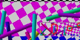

Currently I am writing a short tutorial about anti-aliasing and during the
rendering of several test images, I discovered the effect of bleeding colors
(rough translation from German, sorry). In English, certain color
combinations do not show an quality improvement during rendering with
anti-aliasing. Instead an unwanted color appears. In my example, a dark blue
appears between a light blue and magenta. See the marked area in the
attached image.
After thinking about the algorithms of anti-aliasing I seems pretty clear to
me, that such effect can occur. Anti-aliasing averages colors to find a more
suitable color at edges and so tries to improve the image quality. But the
average between a light blue and magenta is dark blue, even when this means
stressing the edge instead of smoothing it.
I tried both anti-aliasing methods and different settings (deepness,
threshold). A similar effect occurs in all graphics applications during
resizing of images with smart interpolation algorithms. These resizing
algorihms also average colors to deliver better results and therefore get
cought in the same problem.
Does anyone know a way to suppress this strange but quite logical behavior?
Would it make sense to use an averaging algorithm based on HSL instead of
RGB to improve the results? Of course, it could also be a problem without
any solution. Comments are welcome.
Thanks,
Rene

From: hughes, b
Subject: Re: Anti-Aliasing Problem including sample image (58k)
Date: 26 Nov 2002 18:30:16
Message: <3de40408@news.povray.org>
"Rene Schwietzke" <r.s### [at] reneschwietzkede> wrote in message
news:3de3fb74@news.povray.org...
---snip---
to
more
means
---snip---
behavior?
Good example. Yellow against magenta also looks a little strange to me. And
where the blue checkers are the yellow and light green cylinders darken. If
other programs also do this like you say then it sounds like a holy grail
idea, but maybe a good one anyway.If I only knew how HSL would effect it...

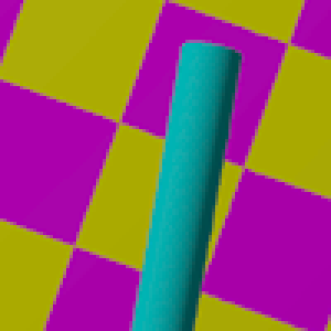

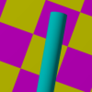

For high quality images, it's the best to render them without AA but twice the
size and then use P'shop to downsample them. See the attached (3x magnified)
examples. One is just POV with +AA0.0 +AM2, the other one is resampled
with Photoshop. If I remember right, ImageMagic works fine with CIE L*a*b,
so maybe it could also be used, but I have not checked this out.

> Thats not completely true. Photoshop uses internal the CIE L*a*b color
> format for all image processing and does avoid that unwanted color
blending.
> L*a*b is also a possible color format for TIFF images but most image
> viewers (like IrfanView) do not display this format correctly, maybe thats
the
> reason that not so many people know about it.
the
magnified)
