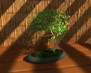

This is a bonsai scene I have been playing with on and off for a while.  I'd
like to add some media to create a slightly dusty/hazy look that would
highlight the light beams a little and maybe give the image a little extra
something.  Any advice on how to create a media that would do that would be
appreciated.
Patrick Dugan
Download 'Bonsai.jpg' (96 KB)
Preview of image 'Bonsai.jpg'

Since you're using an area light, and area lights + media are a bad idea
when avoidable, I'd suggest this approach:
1. Put the entire scene you have right now (excluding the camera) into a
light_group.
2. Inside a separate light_group, create a plane whose surface coincides
with the backside of the bamboo wall. Make sure the tree and camera are
*inside* this plane. Make the plane hollow and transparent and give it an
interior something like
interior {
media {
scattering {2, .01}
// experiment with different scattering types (like type 1, or type 5 with
different eccentricity values)
// if the media is too heavy, lower the .01; if its too invisible, bring the
.01 up higher.
// if there's simply too much darkness for the lighting effects that are
created, then add "extinction .5" and fiddle with the .5 until it looks
good.
3. Put a light source identical to your area light inside this light_group,
but *don't make it an area light*. That way, the solid objects in the scene
will be lit with an area light, but the media will be lit with a point
light. This will speed up the render a *lot* and the difference probably
won't be noticeable.

Nice...the bark and leaves look too brightly lit though, do they have a
high ambient?
Anyway, what you want is scattering media, without a density pattern,
and with a very dim scattering color. Type 4 (Rayleigh) scattering is
probably the best for this. If it is invisible, boost the scattering
amount, if everything is black or white, lower it.
http://tag.povray.org/

I have no advice to give (haven't played with scattering media)
but I wanted to say I like your bonsai a lot.
How it was made?.

From: Patrick Dugan
Subject: Re: bonsai scene ~96k
Date: 7 Nov 2002 22:05:59
Message: <3dcb2a17@news.povray.org>
Thank you!  The tree was created using Gilles Tran wonderful tree macro.
The rest was modeled within Povray by hand.  The bamboo was made using SOR
objects.

Okay, I'll show my stupidity here.  If I use a plane that is parallel to the
back wall won't it be flat?  How can the
tree and camera be inside it?  I could see a box since it would "fill" the
scene but I don't understand using a plane.
"Slime" <slm### [at] slimelandcom> wrote in message

I think he means you'll have to create a plane and rotate it
so the +y axis of the plane points to the tree and camera.
Bye
the
Planes have insides and outsides just like boxes or spheres. The
"underneath" part of a plane is considered to be "inside" it. So just make
sure the normal of the plane points *away* from the camera, so that the
camera is "underneath" it.
 - Slime

Impressive! I can't wait to see it with media.
My only nit to pick is that the whole bonsai - even the leaves - seems
luxophobic. Shouldn't at least the leaves make some effort to point to
the light, instead of away from it?
Peter Popov ICQ : 15002700
