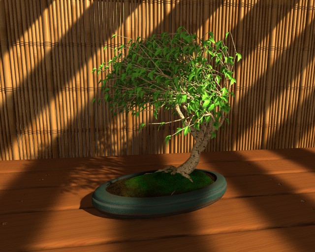

This is a bonsai scene I have been playing with on and off for a while.  I'd
like to add some media to create a slightly dusty/hazy look that would
highlight the light beams a little and maybe give the image a little extra
something.  Any advice on how to create a media that would do that would be
appreciated.

From: Slime
Subject: Re: bonsai scene ~96k
Date: 7 Nov 2002 21:21:58
Message: <3dcb1fc6$1@news.povray.org>
I'd
be
> appreciated.
Since you're using an area light, and area lights + media are a bad idea
when avoidable, I'd suggest this approach:
1. Put the entire scene you have right now (excluding the camera) into a
light_group.
2. Inside a separate light_group, create a plane whose surface coincides
with the backside of the bamboo wall. Make sure the tree and camera are
*inside* this plane. Make the plane hollow and transparent and give it an
interior something like
interior {
media {
scattering {2, .01}
// experiment with different scattering types (like type 1, or type 5 with
different eccentricity values)
// if the media is too heavy, lower the .01; if its too invisible, bring the
.01 up higher.
// if there's simply too much darkness for the lighting effects that are
created, then add "extinction .5" and fiddle with the .5 until it looks
good.
3. Put a light source identical to your area light inside this light_group,
but *don't make it an area light*. That way, the solid objects in the scene
will be lit with an area light, but the media will be lit with a point
light. This will speed up the render a *lot* and the difference probably
won't be noticeable.
 - Slime
[ http://www.slimeland.com/ ]
From: Christopher James Huff
Date: 7 Nov 2002 21:25:50
Message: <chrishuff-87EAB0.21255107112002@netplex.aussie.org>
In article <3dcb12c3@news.povray.org>,
> appreciated.
Nice...the bark and leaves look too brightly lit though, do they have a
high ambient?
Anyway, what you want is scattering media, without a density pattern,
and with a very dim scattering color. Type 4 (Rayleigh) scattering is
probably the best for this. If it is invisible, boost the scattering
amount, if everything is black or white, lower it.
http://tag.povray.org/

From: Patrick Dugan
Date: 7 Nov 2002 22:05:59
Message: <3dcb2a17@news.povray.org>
Thank you!  The tree was created using Gilles Tran wonderful tree macro.
The rest was modeled within Povray by hand.  The bamboo was made using SOR
objects.

From: Patrick Dugan
Date: 7 Nov 2002 22:18:27
Message: <3dcb2d03@news.povray.org>
Okay, I'll show my stupidity here.  If I use a plane that is parallel to the
back wall won't it be flat?  How can the
tree and camera be inside it?  I could see a box since it would "fill" the
scene but I don't understand using a plane.
"Slime" <slm### [at] slimelandcom> wrote in message
news:3dcb1fc6$1@news.povray.org...
> I'd
extra
> be
> > appreciated.
> light_group.
> interior {
> media {
> scattering {2, .01}
the
> .01 up higher.
> good.
light_group,
scene
>  - Slime

I think he means you'll have to create a plane and rotate it
so the +y axis of the plane points to the tree and camera.
Bye

From: Slime
Date: 7 Nov 2002 22:53:31
Message: <3dcb353b@news.povray.org>
the
Planes have insides and outsides just like boxes or spheres. The
"underneath" part of a plane is considered to be "inside" it. So just make
sure the normal of the plane points *away* from the camera, so that the
camera is "underneath" it.
 - Slime
From: Peter Popov
Date: 8 Nov 2002 05:34:27
Message: <nm4nsuk6i4ut4bfl0e9kqi2dpvqt4c3e8a@4ax.com>
On Thu, 7 Nov 2002 19:25:26 -0600, "Patrick Dugan"
>appreciated.
Impressive! I can't wait to see it with media.
My only nit to pick is that the whole bonsai - even the leaves - seems
luxophobic. Shouldn't at least the leaves make some effort to point to
the light, instead of away from it?
Peter Popov ICQ : 15002700
