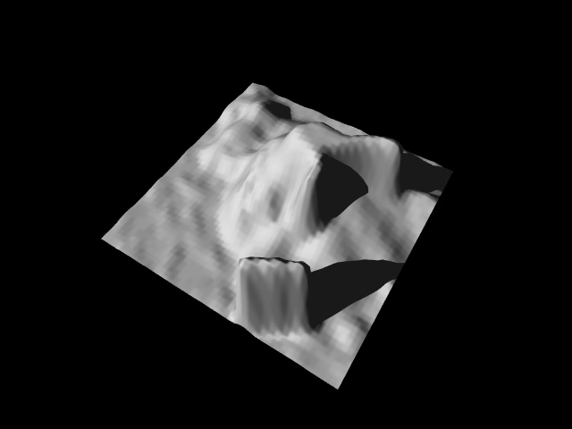

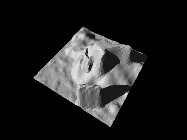

Normally, the triangles in each "square" of a height field are always the
lower left and upper right of the square. I've implemented a
"smart_triangulation" keyword which makes POV-Ray choose which way to
triangulate the squares better, often creating a smoother result. An example
of both methods is attached to this post. When used with the smooth height
field bug fix and my shadow line fix, this creates an extremely smooth
height field.
I *think* there's only one more feature that I want to attempt before I
release this.
 - Slime
[ http://www.slimeland.com/ ]
Download 'height_field_normal_triangulation.jpg' (47 KB) Download 'height_field_smart_triangulation.jpg' (44 KB)

From: Hugo
Subject: Re: Another height field improvement
Date: 19 Oct 2002 17:10:28
Message: <3db1ca44@news.povray.org>
> I've implemented a "smart_triangulation" keyword
Oohh, you took my idea there.  ;o)  I did this in SDL a few months ago,
remember?  Very nice to see this will soon become native part of POV.
Thanks,
Hugo

From: Zeger Knaepen
Subject: Re: Another height field improvement (another image)
Date: 19 Oct 2002 17:50:40
Message: <3db1d3b0$1@news.povray.org>
"Slime" <slm### [at] slimelandcom> schreef in bericht
news:3db1c5c9@news.povray.org...
> > height field.
> Like this. (I admit I slightly changed a small part of the height field
that
> was casting an ugly tiny shadow on itself.)
Sorry, not good enough...  Look at my post a couple of months ago, where I
compare smooth height_fields with a mesh of smooth_triangles.  With a
height_field, you can still see the outline of the triangles, it looks like
the shading gets smoothed instead of the normals... it's hard to explain,
but I think it's pretty clear if you look at the images I posted.  (I would
look the post up
Don't get me wrong, I do appreciate your efforts in making the height_field
object better, but I would just really like that problem fixed.
cu!
whoops, update:
you wrote, in a reply to Christoph Hormann:
"Heh, actually, I've already used this syntax to let the user choose between
POV-Ray 3.5's normal calculation (1) and a different type of normal
calculation that I came up with (2) which tends to look better overall.
(POV-Ray bases the normal of a vertex on the vertices diagonally across from
it; I base it off of the vertices adjacent to it.)"
I think that's what I talking about.
If so: whoohoo!!!!!!!  Finally height_fields will be really useful!! :)
If not: :(((((
cu!
ZK AKA SaD
http://www.povplace.be.tf
"Surely you've heard of silicon heaven?"

From: Slime
Date: 19 Oct 2002 18:15:20
Message: <3db1d978$1@news.povray.org>
from
It might be. While I base the normals off of the adjacent vertices in smooth
type 2, the normal interpolation is still done in squares. That is, with a
smooth mesh, the normals of each triangle are interpolated between on that
triangle. With a smooth height field, the normals of every *pair* of
triangles are interpolated between. This somewhat creates a grid effect.
However, I did originally attempt to make it look more like a smooth mesh,
and decided in the end that the height field interpolation type actually
looked better. It works slightly differently, but in the end I think it
produces a smoother looking result.
 - Slime
