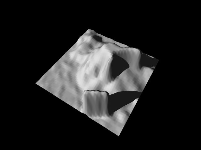

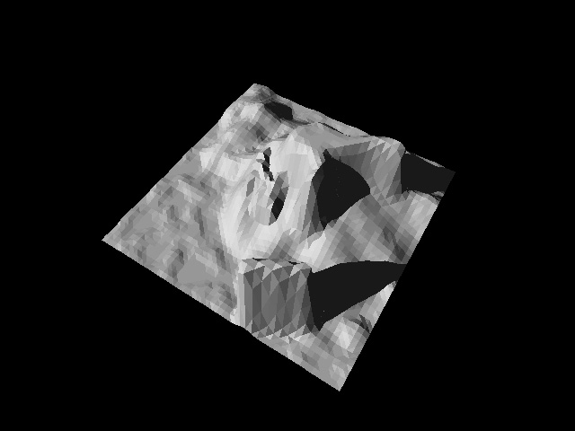

Normally, the triangles in each "square" of a height field are always the
lower left and upper right of the square. I've implemented a
"smart_triangulation" keyword which makes POV-Ray choose which way to
triangulate the squares better, often creating a smoother result. An example
of both methods is attached to this post. When used with the smooth height
field bug fix and my shadow line fix, this creates an extremely smooth
height field.
I *think* there's only one more feature that I want to attempt before I
release this.
 - Slime
[ http://www.slimeland.com/ ]
Download 'height_field_normal_triangulation.jpg' (47 KB) Download 'height_field_smart_triangulation.jpg' (44 KB)
Preview of image 'height_field_normal_triangulation.jpg'
Preview of image 'height_field_smart_triangulation.jpg'

From: Hugo
Subject: Re: Another height field improvement
Date: 19 Oct 2002 17:10:28
Message: <3db1ca44@news.povray.org>
> I've implemented a "smart_triangulation" keyword
Oohh, you took my idea there.  ;o)  I did this in SDL a few months ago,
remember?  Very nice to see this will soon become native part of POV.
Thanks,
Hugo

From: Rafal 'Raf256' Maj
Subject: Re: Another height field improvement (another image)
Date: 19 Oct 2002 18:11:24
Message: <Xns92AD1A8CF162raf256com@204.213.191.226>
"Slime" <slm### [at] slimelandcom> wrote in news:3db1c5c9@news.povray.org
Very nice :)
Keep up good work :)
