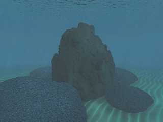

If I get this finished in time I'll be amazed....
Can anyone give me a few ideas as to how to deform an iso-surface (the sand)
where the rock and corals rest?

I'm in absolutely no position to criticize your or anyone else's work
here (total newbie :-), but I thought I'd mention this, since it also
caught my eye in your previous version.
The lighting pattern that the water waves cause on the bottom sand,
appear too uniform in this picture, IMHO. They seem too parallel, like
a bunch of sine waves with the same period and amplitude. I notice
some variation here and there, but the overall look is uniform to me.
Wald
From: Tom Melly
Subject: Re: underwater landscape latest wip [27kb]
Date: 7 Oct 2002 11:02:16
Message: <3da1a1f8$1@news.povray.org>
"Wald" <arn### [at] n-o_s-p-a-magrkuleuvenacbe> wrote in message
news:3da19f1f$1@news.povray.org...
Actually, the pattern you are seeing is the ocean floor (an iso-surface). I'm
not quite sure why the crest of each ridge gets highlighted quite so much,
although nor am I convinced that such lighting is unrealistic.
The caustics cast by the ocean surface are much subtler.
That aside, even the ocean floor probably needs a bit more turbulence than is
seen here. Thanks.

From:
Date: 9 Oct 2002 23:38:16
Message: <3da4f628@news.povray.org>
news:3da1a1f8$1@news.povray.org...
I'm
I found such lighting very unrealistic. It seems as if the water has waves
in only one dimension, which in a general oceanic environment, is virtually
impossible.
However, I must say I'm utterly impressed by the corals.
Fernando.
