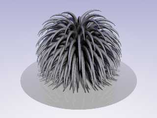

What you see are 250 strands of hair.
The base-positions for these were generated using
the electrostatic-repulsion algorithm I implemented
some days ago.
Each hair uses 15 nodes, which are connected with
springs. Calculating the forces, gravity, hair-strength
etc required approximately 25*50=1250 iterations
to get to this state.
The calculation for this kind of furball is only worth it
if hair has to lie on the floor and needs to stay
out of other objects, otherwise the faster and simpler
algorithm I used in former images is sufficient...
Comments?
Tim Nikias
Email: Tim### [at] gmxde
Download 'furball.jpg' (50 KB)
Preview of image 'furball.jpg'
> some days ago.
> Comments?
Nice, does it have collision detection between the hairs?

Nope. I did implement the repulsion-algorithm once, but since I'm
no expert on this field, the hairs would explode...
I know, I should try putting springs between nodes which are too
close, but didn't have the patience to do so yet. That'll be the next
phase.
Before I do that, I want to see how I can combine the two methods
(the dirty easy one I used before and the realistic one now) in order
to speed parsing a little, and put the nodes somewhere near a position
they would finally be if it weren't for obstacles...

I look forward to see your next implementations! This one is good!  But I
would think twice before touching it with my hand.  ;o)
Hugo
If you don't want to create animations but just want the final result you
could try implementing a gradient descent method.  This means you don't
actually integrate the equations of movement but move the nodes according
to the gradient of the potential field of all (static) forces influencing
it.  This would avoid the possible instability and oscillation problems
but of course can lead to wrong results as well.

If this involves (and I'm pretty sure it does) functions, then
that's a no-no... I didn't have the time yet to fully understand
functions (I know, they're not THAT difficult), and once I
get comfortable with them and really grasp them, I guess
I could tackle a lot of stuff (concerning animations, objects,
repulsion etc)...
But until then, I'd like to stay focussed on what I'm already
capable of, and move further when I've got more time and
less stress...
Still, thanks for the suggestion, I'll keep it in mind.

Thanks! Yeah, this one looks rather "solid"...
> that's a no-no...
No, it does not (although it could simplify certain things to use
functions, for example you could use the gradient calculation macros from
'math.inc').
