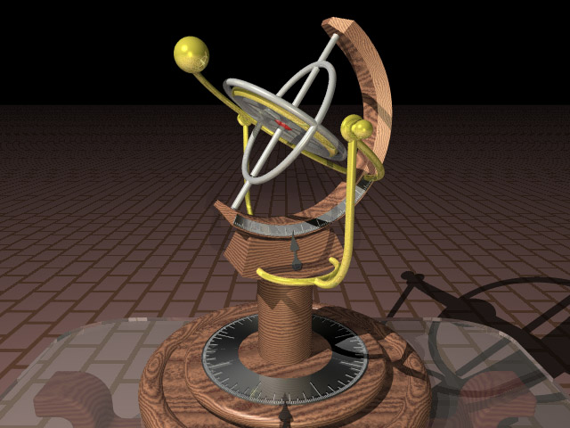

Hi All,
This is a model of a gyroscope I've been working on for a larger picture.  I
like the shape, and basic design but I don't like how a lot of the textures
turned out.  The gyroscope Mass and housing should be "polished stainless
steel"  while the outer holder is brass.  Both look like plastic.  Also the
wood on the base turned out nice, but the rest just doesn't seem right.
Wood on flat or near flat surfaces like the base seems pretty easy, does
anyone have any advice on wood over curving or cylindrical surfaces?  As
always any other advice or comments are gladly accepted.
JFMILLER
Download 'Room.jpg' (84 KB)
Preview of image 'Room.jpg'

For the metal, try the "metallic" and "reflection" keywords.  For the wood
that doesn't look right, try rotating the grain pattern.
Cheers!
Chip Shults

The brilliance keyword is pretty important when working with metal
textures. Bump it up to brilliance 5 or 10 or so. Also, reflective
surfaces need something to reflect in order to look good. Try adding a
sky_sphere.
And as jfmiller said, rotate the wood pattern. I would try rotate x*95
for the wooden cylinder.
/ martin

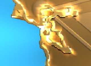

I don't have much experience with wood textures, but here's a little trick
that can help metal textures look a little better: put a plane or dome shape
well behind the camera, and give it a suitably scaled black and white or
grey bozo pigment. I usually just use the included metal textures (T_Gold_3D
and T_Gold_5E are my favorites), and this technique often adds some
interesting highlights to the metal parts of a scene.
Another trick I stumbled on once was to use radiosity to get a glowing
"aura" around the edges of a metal surface. It's hard to duplicate, but
looks pretty cool. Here's a little example to illustrate...
Dave Blandston
PS - Nice job on the modeling. I like the wooden base as it is, except the
glass and stand underneath look a little awkward to me.

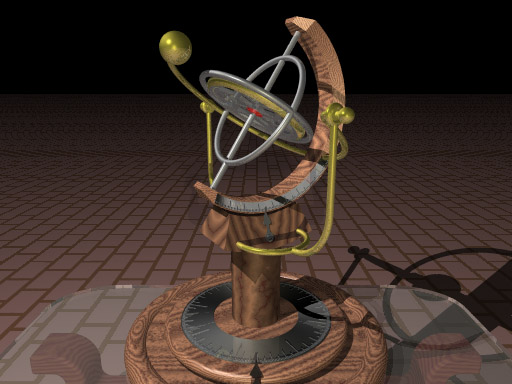

Thank you all for your help.  Here is the new version.  I still think I need
to play with the orientation of the wood texture on the upper part of the
bace but at least now it doesn't look like it's been atacked by a Zebra.
I'm not going to worry too much about adding something like a sky sphere to
reflect sence this modle will end up in a larger seen with walls roof and
objects to provide reflecting texture.
Once again thanks for the help.
JFMILLER

don't know if this is doable, but here it goes....
I don't think that your gyroscope is made out of only a few pieces of wood,
but I would guess that there are more seperate parts of wood per surface.
what I'm trying to say is this: think about how you would go about
constructing this in real life... what parts do you need? then have that
come back in the picture. you would get seams and textures that don't flow
on over whole surfaces.
also/mainly: take a look at the big block of wood with the arrow on it. Is
that possible? the texture seems off to me. a tree grows in circles, but I'm
not able to translate that block to some shape that would make the texture
circular, if you know what I mean...
