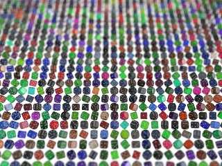

Hi,
here we go! Another dice theme variation. I redesigned the dice by improving
texture, iterior, and the white dots are much simpler now (based on spheres
instead of a csg(cylinder, sphere, box)).
I am not fully satisfied with the dice shape itself. It does not fully match
a real dice. But I did not found the right csg operations and objects to
model it (meshes are not an option). Later I will render an image with
several dice designs, just to get a little bit feedback.
Have a nice day.
Rene
Give superellipsoid a try.
    Why not do Vegas-quality dice ? They're perfect cubes ! Though, then,
for realism, you would need to vary the size or depth of the spots on each
side to keep the dice perfectly balanced.
But, in the end, even Vegas dice are a little rounded on the edges, aren't
they? Naturally, This would only show on a close-up but, for realism ;-)

    Oh, no, I should really kill every one that reads this, but they grow
crystals of a top-secret ultra-rare cubic-atomed element - just don't tell
anyone I told you so...

I can see a little problem with the way the dots are put on the faces of
your dice.  The diagonal line made by the "three" and the one made by
the "two" should meet at the corner (on the side where "six" is).  You
can see that it does not in your image.

I will check this and correct.
