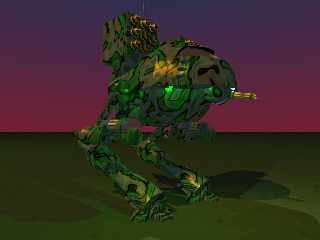

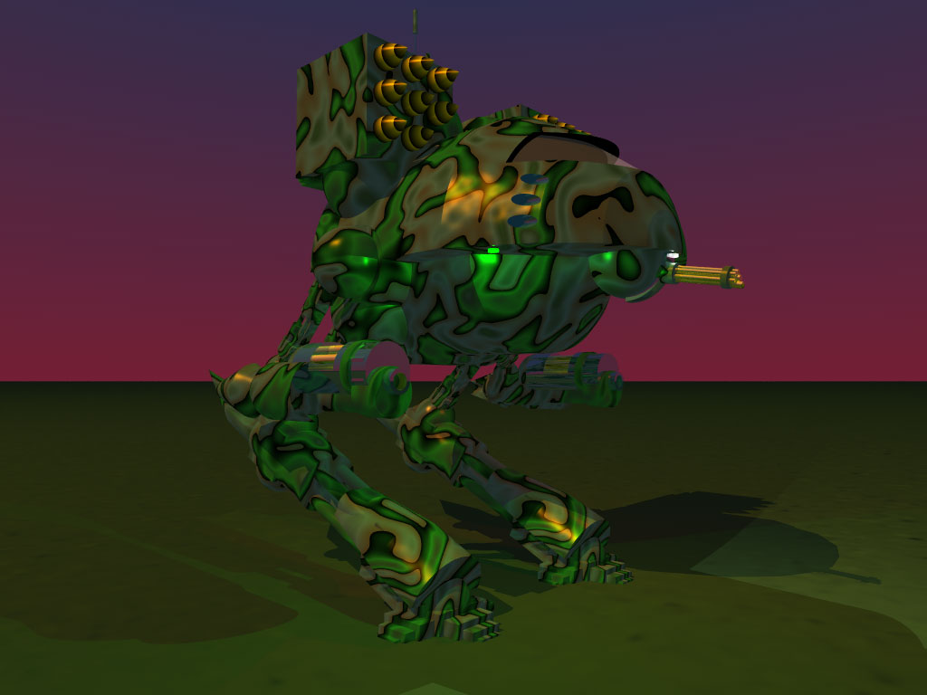

Hello Again,
I'm trying to give it a more *worn-out* look, does anyone have any
suggestions? I also added some ship-like position lights, and I've still not
started to work on the background, but I think its gonna be some kind of
midnight/desert theme.
f00

Agree. It could use a been-in-battle look. Right now it looks more
like a mech on LSD or something.. ;)
I'm a Moray user so I don't know if the same textures exists in
Povray but I've got some rusty iron textures that look quite good
if you tweak them a little.
Another way is to use imagemaps.
The modelling is coming along good. Keep it up.

The first thing I'd say to you is that it looks too uniform.  It looks
like you have one union, and the texture assigned to the whole thing.
 Try subdeviding it, and applying the texture seperatly, maybe even
having slight differences in the texture applied to the left arm, say,
as opposed to the right leg.
Also, your texture is too shiny... play with the settings and see if you
can get a more matte surface.
Maybe a spot of bondo or two?
Some rust?

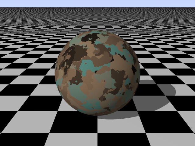

From: JPGargoyle
Subject: Re: Battlemech WIP *used* look ?
Date: 12 Aug 2002 19:15:55
Message: <3d5841ab@news.povray.org>
Well this is somrthing about your request on a camouflage texture.
I came up with this texture while I was making some experiments on a texture
that someone posted here in this news group.
(It was a texture used in the ground, but I can't remember the name of the
author.)
So while playing with its values I achieved this texture. Its no big deal
but its a starting point.
Best regards.

From: JPGargoyle
Date: 13 Aug 2002 09:25:06
Message: <web.3d59088c6956d829641f1e9f0@news.povray.org>
f00 wrote:
>Thanks alot for this, I think I can make some use of it ;-) I'll post a new
>WIP pic later today.
De nada!
You are welcome :)
I am looking forward to see it.
Best regards.
From: krus
Date: 13 Aug 2002 10:05:15
Message: <web.3d5911b36956d8292f4bd1e30@news.povray.org>
JPGargoyle wrote:
>De nada!
>You are welcome :)
>Best regards.
JPGargoyle's eks is fine but u might want to try a tweak
#declare T1 = texture {
     pigment {
         cells
         turbulence 8
         color_map {
              [0 color rgb Black]
              [0.8 rgb SemiSweetChoc]
              [1 rgb HuntersGreen]
like from a wet surface could look wornout and used
regard krus
