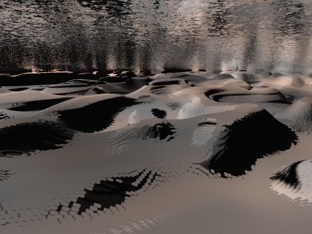

Ok, I have the scene set up, but I want to get a good media for the water.
It should be slightly green and I want to see light rays casting down from
the sun.
I have tried, but I just can't get the hang of it.

From: Simon Adameit
Subject: Re: Undersea
Date: 29 Jul 2002 13:10:22
Message: <3d4576fe@news.povray.org>
> the sun.
Use scattering media type 2 or 3 together with absorbing media and of course
faked caustics.
Simon
From: Samuel Benge
Date: 29 Jul 2002 13:59:04
Message: <3D458263.7070201@caltel.com>
For starters, try:
media{ scattering{5,.01 extinction .001} method 3 }
Don't forget the 'hollow' keyword in the object block; it's so easily
left out sometimes.
Nice water, by the way. What happened to your height_field, though? It's
got some strange artifacts I haven't seen before. What color depth did
you use when making it?
> the sun.
Samuel Benge
sbe### [at] caltelcom
From: Bryan
Date: 30 Jul 2002 01:40:57
Message: <3d4626e9$1@news.povray.org>
"Samuel Benge" <sbe### [at] caltelcom> wrote in message
news:3D4### [at] caltelcom...
> For starters, try:
> left out sometimes.
I remembered
Thanks.
I used a GrayScale TGA and I agree, I am NOT happy with it.

From: Bryan Valencia
Date: 31 Jul 2002 13:14:02
Message: <3d481ada$1@news.povray.org>
Hmmm I tried that (media{ scattering{5,.01 extinction .001} method 3 }) and
the image took 2 hours to render and was totally white. :(  I tried changing
the media settings, but  I just don't get it.

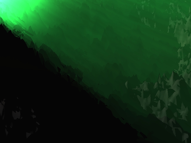

From: Bryan
Subject: Re: Undersea (80K)
Date: 1 Aug 2002 02:08:57
Message: <3d48d079@news.povray.org>
This is much better...
    interior{
        ior 1.33
        media{
            samples 1,1
            scattering{3,rgb<0.5,3,1>*0.001 extinction .01}
            method 3
"Bryan Valencia" <bry### [at] 209softwarecom> wrote in message
news:3d481ada$1@news.povray.org...
and
changing
Download 'undersea.jpg' (81 KB)
Preview of image 'undersea.jpg'
