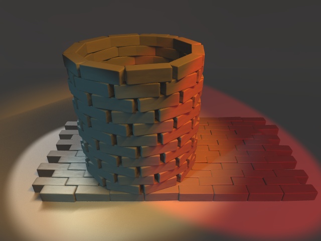

on disk i found a piece of a scene i made long time ago. it is a macro
which makes a floor, a wall and a well. the well part of macro is buggy as
everyone can see. that is because i have no solution for the question: on a
defined stone and a nearly given radius how many complete stones can be
positioned to fill a circle and how great is radius then? is there a
formular i can use? for help i would be appreciated. for comments on the
pic, too.
Download 'well.jpg' (50 KB)
Preview of image 'well.jpg'
I'd attack it like this:
The interior faces of the bricks form a regular N-gon with the side
equal to the length of the brick. Determine the sizes of regular N-gons
with unit size and pick the one that most nearly matches the given
radius.
Let's call the distance from the centre of the circle to the midpoint of
an edge "R". (It's not a true radius, particularly in cases where N is
odd).
We know that the sum of the angles at the centre is 2*Pi, and that the
N-gon is regular, so each edge subtends an angle of 2*Pi/N at the
centre.
Lets draw a right angled triangle connecting the centre of the circle,
the centre of an edge and an adjacent vertex. We can see that the angle
at the centre is Pi/N, and it's tangent is 0.5/R (opposite over
adjacent), so
        tan(pi/N) = 0.5/R
i.e.
        R = 1/(2*tan(pi/N))
So
#declare N=3;
#while (1/(2*tan(pi/N)) < given_radius)
  #declare N=N+1;
#end
#declare R = 1/(2*tan(pi/N));
Mike Williams

marabou wrote:
> on a
> formular i can use?
Hello Marabou. Here is some code for you. I tested and re-tested this
code and it works great. Note, Radius must be a multiple of Scale. For
example if Scale is 4, then Radius must be 4, 8, 12, 16, etc. Here is
the code (I added a camera and light_source for convenience):
camera{location<0,40,-40>
  look_at 0
  angle 35
light_source{
  <2,1,-.5>*100000
  ,<1.5 1.45 1.25>*1.7
#declare Scale=1;
#declare Radius=10;
#declare RotateV=0;
#while(RotateV<360)
  superellipsoid{<.2,.2>
   pigment{rgb 1}
   scale< Scale, Scale/2, Scale/2 >
   translate z*Radius
   rotate y*RotateV
  #local RotateV = RotateV+360/Radius/3*Scale;
#end
Samuel Benge
> formular i can use?
I used some formulas in my arch macro. It can do circles too. Just have
a look at:
http://www.b0n541.net/povray/povmacro.html
I hope the comments in the code are not to confusing...
So long,
Bonsai

"Samuel Benge" <sbe### [at] caltelcom> wrote:
> marabou wrote:
> > on a
> > formular i can use?
>   look_at 0
>   angle 35
> light_source{
>   <2,1,-.5>*100000
> #declare Scale=1;
> #declare Radius=10;
> #declare RotateV=0;
> #while(RotateV<360)
>    pigment{rgb 1}
>    translate z*Radius
>    rotate y*RotateV
> #end
#declare Scale=3.2;
Same problem :-(
Regards.

Hmm, radius can be 3.2, 6.4, 12.8, 25.6, etc....
I guess you don't want to use a decimal radius?
Philippe Lhoste wrote:
> #declare Scale=3.2;
> Same problem :-(
> Regards.
Samuel Benge
From: Philippe Lhoste
Subject: Re: well [49.7kb]
Date: 26 Jul 2002 12:34:21
Message: <3d417a0d$1@news.povray.org>
> > #declare Scale=3.2;
> > Same problem :-(
> > Regards.
Oh well, as usual, problem between keyboard and chair...
I didn't read your note about the relationship between radius and scale.
I added it as a comment in your code snippet.
Thank you for this useful piece of code.
