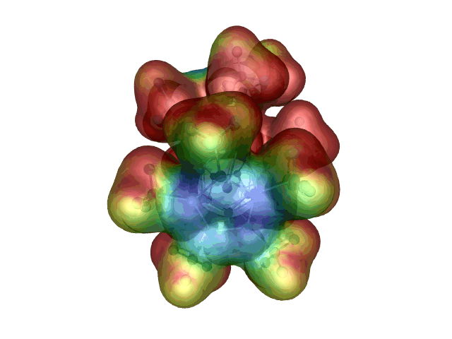

This is the electrostatic potential of a new, never before synthesized
'triple decker' organometallic 'sandwich compound', superimposed on its
electron density.  The synthesis and structure of the compound was just
recently published in Angew. Chem. Int. Ed. 2002, 41, No. 9.
I calculated the electron density and molecular electrostatic potential
using my normal set of Quantum Chemical software tools.  I generated the
electron density isosurface with my marching cubes code.  I used POV-Ray 3.5
for rendering with a mesh2 structure for the isosurface.   The superposition
of the electrostatic potential was done with a texture per vertex
specification in the mesh2 structure.  The textures were colors that
corresponded to the value of the electrostatic potential at each point on
the electron density surface.  Blue is negative (-0.2 units) and red is
positive (0.2 units).  The other colors ranged between blue and red in
value.  There are 256 colors used.
The spheres and rods viewable through the slightly transparent isosurface
are the atoms and bonds framework of the molecule.
Turned out rather nice.

A very nice image.  I would have thought, though, that the radicals
(methyls?) sticking out in fives would have been at random rotations rather than
aligned.  Hmm, on second thought, maybe that is the lowest energy state, and
what keeps the sandwich stable.  Just looking at the second layer there.
    This is a nice use of the software, and I imagine that somebody somewhere
working on MEMS and nanotech will be using POVray to start imaging some of their
work soon.

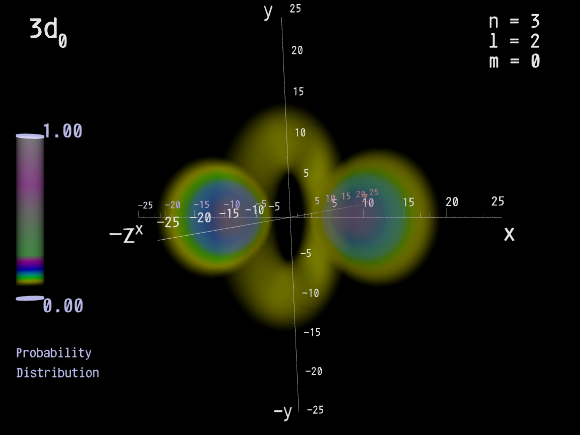

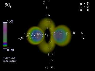

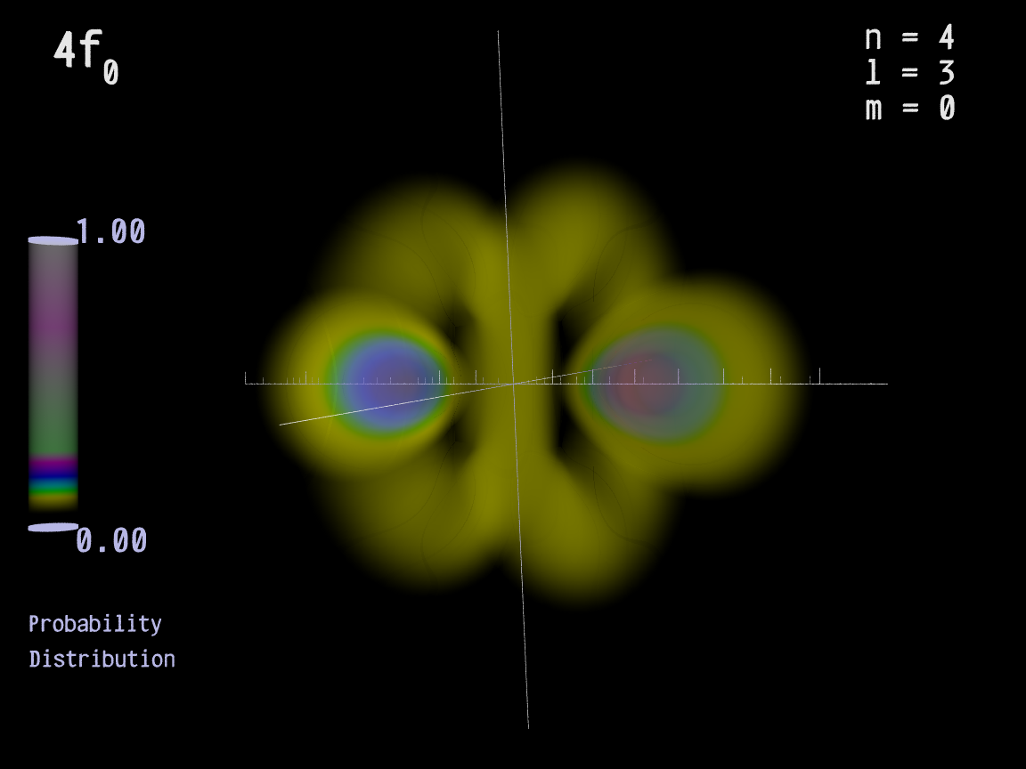

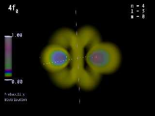

Further on you talk about electrostatic potential. Is it correct that you
mean with that the energy potential of a atom caused by the net charge
of the nucleus and his electrons?
If so, is it possible to calculate this for bounded atoms as well, using
Molecular Orbitals?
Jaap Frank

From: Jaap Frank
Subject: Re: Mesh2 Potential on Density - Novel Triple Decker Organometallic Sandwich Compound
Date: 22 Jul 2002 13:12:27
Message: <3d3c3cfb@news.povray.org>
??? Outlook Express thinks these .PNG files might contain a virus !!!!!!!
Has anybody else got the same experience ???
I can asure you that they are pictures and nothing else.
Jaap Frank.

> I can't read the article (or can you reach it via internet?), so I ask you
> directly. Is it one central atom (or ion) or are there two of them? And
> what is it? Magnesium or a heavier kind?
There are 3 central atoms.  They are all Ruthenium (Ru).  The other 91 atoms
are Carbon, and Hydrogen.  The molecule is at the experimental geometry and
is a +2 ion with no unpaired electrons.
> Molecular Orbitals?
The electrostatic potential of the molecule represents the interaction
between the charge distribution of the molecule and a unit point charge
located at some position p.  It is calculated using molecular orbitals and
nuclear substructure that characterize the molecular system.
