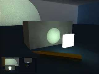

as i wanted to proof from where my spotlight does come i found a strange
thing: the light goes through a wall a can be seen on the wall behind! and
no shadows can be seen!
how could this happen?
here is a code fragment:

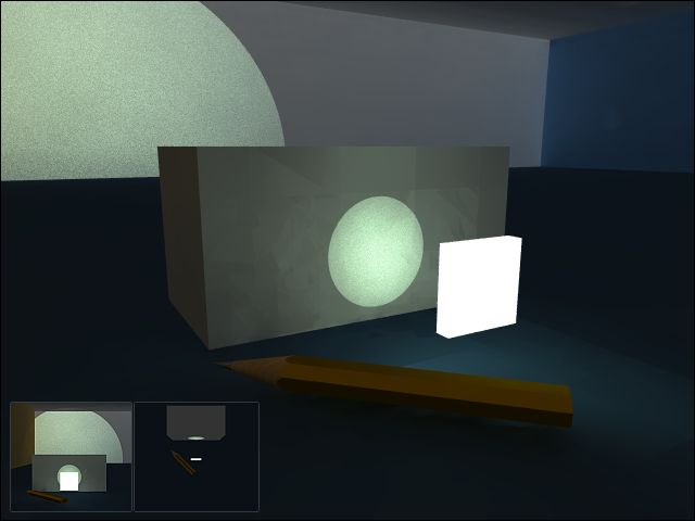

From: marabou
Subject: Re: strange: light goes through wall
Date: 5 Jul 2002 04:13:47
Message: <3d25553b@news.povray.org>
for all those who had a lough about last post: i found the mistake now.
