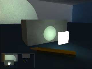

as i wanted to proof from where my spotlight does come i found a strange
thing: the light goes through a wall a can be seen on the wall behind! and
no shadows can be seen!
how could this happen?
here is a code fragment:
#macro Spotlight(noBox, goColor, ang_x, ang_y, ang_z, trans_x, trans_y,
trans_z, radi, fallo)
union{
#if (!noBox)
box{
        <-0.1,-0.1,0.01>,<0.1,0.1,0.05>
        pigment {color goColor*2}
        finish{
                ambient 1
#end//if
#declare myradius = radi;
#declare myfalloff = fallo;
#declare area_no = 4;
light_source{
        <0,0,0>
        color goColor*2
        spotlight
        point_at <0,0,10>
        area_light <-0.5,-0.5,0>,<0.5,0.5,0>,area_no,area_no
        adaptive 1
        jitter
        radius myradius
        falloff myfalloff
        tightness 10
rotate <ang_x, ang_y, ang_z>
translate <trans_x, trans_y, trans_z>
}//union
#end //Spotlight()
box{
        <-0.5,-0.5,-0.005>,<0.5,0.5,0.5>
        pigment {color White}
        translate <0,0,-0.05>
object{
        Spotlight(0,<193,255,194>/255, 0, 0, 0, 0, 0.2, -0.5, 20, 20)

for all those who had a lough about last post: i found the mistake now.
