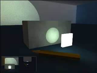

as i wanted to proof from where my spotlight does come i found a strange
thing: the light goes through a wall a can be seen on the wall behind! and
no shadows can be seen!
how could this happen?

Download 'strange.jpg' (21 KB)
Preview of image 'strange.jpg'
